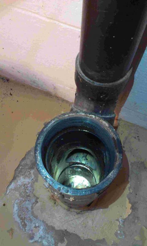

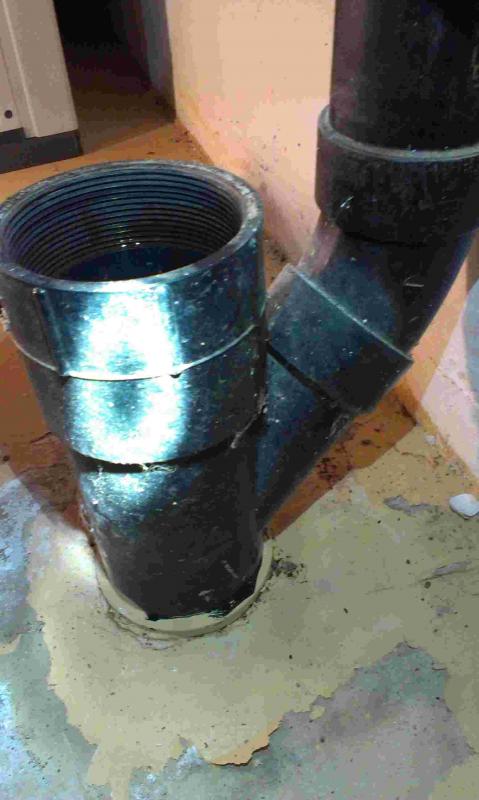

There is a leak occurring somewhere right near ground level in the main drain stack shown in the picture. The leak comes up from between the outside of the ABS 4" drain and the concrete floor, near the back of the drain (closest to the wall and underneath the 3" house drain pipe). There is no water on the outside of the drain, so the water is coming up from the concrete. When I leave a sink running, I can see the pool of water start to form at the back of the drain pipe, but then when I turn off the faucet and clean up the water, it will still continue to give a smaller amount of water overnight, even without use of anything attached to that drain.
I plugged up the drain pipe to hold water in it, and the leak seems to continue to occur when the water level is right at or just below floor level. Right at the concrete floor, the plastic drain bevels out to a slightly larger diameter. Inside the drain, I can see a gap all the way around the pipe that corresponds to that area, so it looks like there is some kind of a ring that they have manufactured into the drain. I think the leak is occurring somewhere in or at the edge of that ring. You can see the gap in the picture that shows the inside of the drain, and it is right below the opening of the 3" house drain.
What purpose does that gap provide?
I've tried to look in there with a mirror, but can't see very well, so I can't find the exact leak. I don't know if there is a good cleaner which would clean up that area without damaging the ABS, so that maybe I could see better?
Can that gap just be filled in with an epoxy or putty. Or does it allow for expansion or exist for some other purpose so that it can't be filled in to be flush with the rest of the inside of the pipe? If I could just fill in that gap, I think that would probably solve the problem.
If it can't be patched from the inside, would I need to chisel around the concrete to apply some kind of patch on the outside?

The house is about 25 years old, so I assumed the whole drain was ABS, but I don't know for sure. The cement floor was painted and some of that paint is on the part of the pipe that flares out around in a ring. Some of the paint on the floor around the pipe has flaked off because of the water laying on it.
You can't tell anything about the outside joint by looking inside the pipe. IF it were connected to a clay pipe the fitting at the bottom would be a "red" color and your photo does not indicate that. Besides, ANY "defect" in a vertical pipe would NOT leak unless the water backed up above that point in the pipe. The "gap" should just be the space between the end of the pipe and the "bottom" of the fitting's hub.
If you cut the end of the pipe square, and insert it fully, there's usually little to no gap between the end of the pipe and the bottom of the hub in the fitting, providing proper overlap and minimum friction, strength, and sealing.
One thing is for sure, which is that if the pipe or fitting is leaking, it's going to have to be removed to fix it.
With only the information we have, a positive diagnosis is not likely.
