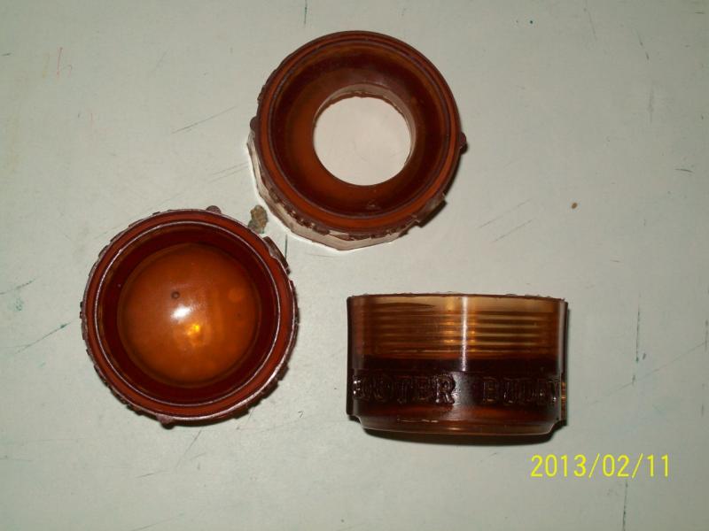

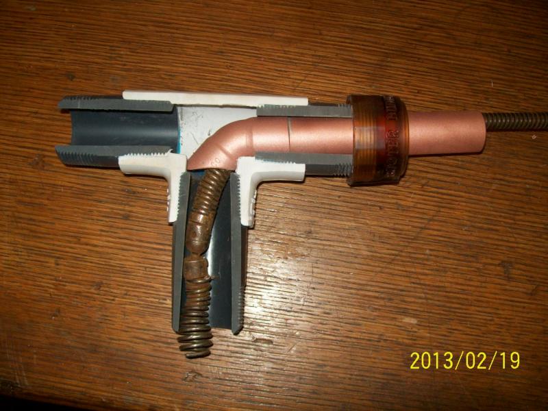

    Here is something I invented from my resin casting ideas. I call it the ROOTER BUDDY. I work on a college campus. This kind of installation is the norm and a real pain in the ass to unstop. My original version was a 3/4 inch 45 and pipe. You have to grind down a portion of the 45 to get it in the pipe. Once in, it just drops down a little and this will allow the cable to easily pass and go down where it needs to.
    Recently we hired a new plumber on the night shift. We went to a similar situation. I whipped this out to stick in the pipe . I let Kevin fiddle for awhile and he could not get the cable to drop. I told him I invented this thing and he said he sure wish he had thought of it. I stuck the 45 in the drain, shoved the cable in and ran it and we had the drain unstopped, put back together and out the door in about ten minutes! Though I don't know all there is to know about plumbing, I'm pretty good at unstopping a drain. Two months later that same scenario happened again but Kevin forgot. I told him I would bring my magic invention over after he and the electrician spent an hour trying to get the cable to go down. I arrived at the scene and my boss was there. He supposedly has 17 years of plumbing experience. He later told me he never thought of doing that after all the times he has endured the same problem and told me I should sell them. BINGO! That's the smartest thing this guy has ever said to me. So, I made up the rubber cap with a nice hole and decided to use 1 inch copper pipe. It also comes with two solid caps for testing to make certain the stoppage is actually cleared. I created this cutaway to show what it is and how it works. They are $35.00 each with free postage to the lower 48 USA. The pipe is 6 inches long. It takes a lot of steps to put a kit together. I cut the bottom off of a pop can and glued to to the end of a 1 1/2 inch PVC adapter. I made a silicone mold of it. I then took the master and cut a hole in it so that the pipe would be a somewhat snug fit. It helps keep it in place so that your two hands can safely operate the drill snake.. I use a rubbery resin from Polytek. It is PT FLEX 60. Mixes 1:1 by volume and cures pretty quickly. These are pressure cast too.

    I know your head won't go through 3/4 inch anything because I run with a 3/8 inch cable with the head cut off. I chose to make them out of 1 inch copper because most people would not think about cutting a head of of a cable and too freaked out at the mention of doing such a thing. You have probably never lost a head off of a cable. It is not good news to get a drain unstopped that you may have had to do battle with only to pull the cable out and find the head snarled in a mess or not there anymore. I sure have. Now you have something new left in the drain to cause another stoppage later.

    Seems like a lot of fiddling around when a drop head is all you need.

    thanks guys.
    drop head did the trick. I ended up pulling out what appeared to be a medium sized cat.
