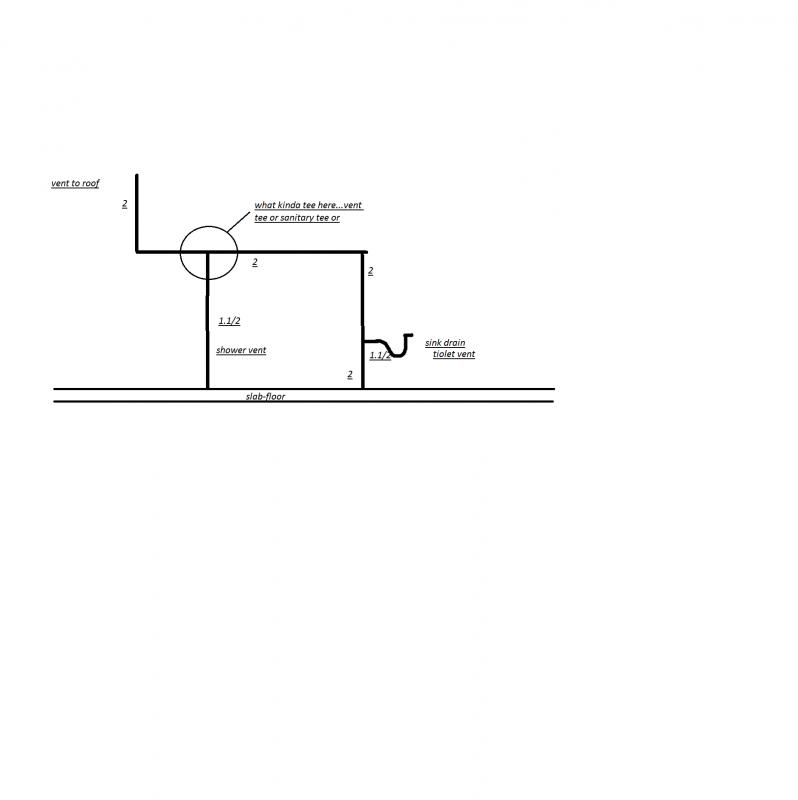

    got one more quick question...in this pic...what kind of tee should go here...Name:  Untitled.jpg
    12,429
    Since that is above the flood level and it's for the vent, a santee works.
    23,534
    You can use a san tee or a "vent tee", although a vent tee usually costs more. The vent through the garage roof has to be a minimum distance away from any second story windows.
