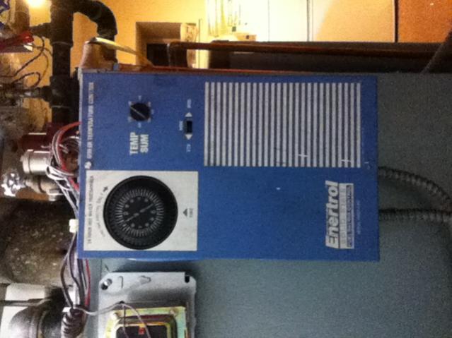

    I have a Smith BB14-*-3 Oil Boiler, Triangle Phase III Indirect Fired water heater, and an Enertrol HWDT-R-S.
    I just moved into the house and I'm trying to "get to know" my system and make sure it is set to be as efficient as possible. The burner itself was tuned up 3 months ago but they didn't touch anything else. I'm curious about the Enertrol settings. The temp dial on it is currently set to 180 here in the CT wintertime. Should that be my year round setting or should I turn it down in the summer. If so turn it down to what. The round "time dial"??? What does that do and what should I set it to? The current time? The time I need the most heat, or hot water, or what? There is also a switch "std/mod". It is currently on std. Is that correct? What does that switch do?
    When I do decide to upgrade the system should I go to a separate electric only H2O heater, these oil bills are killing me!
    A picture of the Enertrol is attached

    Oh boy an Enertrol, blast from the past. If its working correctly the temp should be cranked back to about 140 and the timer, it is for domestic hot water if you had a tankless coil which you don't, should be bypassed. Taco, techmar, Beckett and others make digital models now that are much better. If you really want to cut your oil bill though, it's time to take the beast out of the basement. Take a look at system 2000 or buderus boilers.

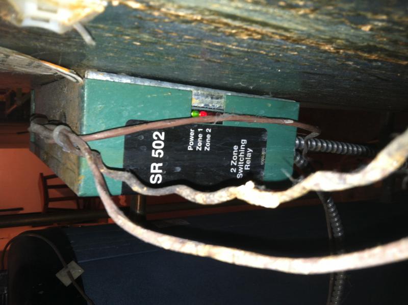

    OK great. I'm pretty sure the timer is bypassed because it doesn't move at all no matter what time I set it for. I do have a Taco SR 502-2 connected to the boiler over by the water heater tank. Should the switch on the Enertrol be in MOD or STD, or is that bypassed too.

    Mod, is your 502 the xt model?
    DIY Junior Member bush8989's Avatar
    Mar 2013
    Ridgefield, CT
    No I don't believe it is. It doesn't say XT anywhere. It just says SR 502 2 zone switching relay 9300-525
    Nov 2010
    Maine
    2,179
    Too has. The xt is set up for tacos pc700 boiler reset control. Plug and play
