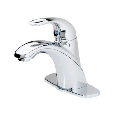

    The bathroom sink is low flow on the hot water too. It is a price pfister.
    Jan 2008
    3,150
    You can pull the cartridge out and let the water flush out the valve body. If I were going to go through the trouble, I would have a new cartridge ready to go in.

    While I'm in there I should just replace the cartridges. Same amount of time and then I won't have to change them again for another 10 years. Hopefully.
    The faucet is a depot cheapo price pfister.
    Will the plumbing supply house cartridge be a better quality than the depot one?
