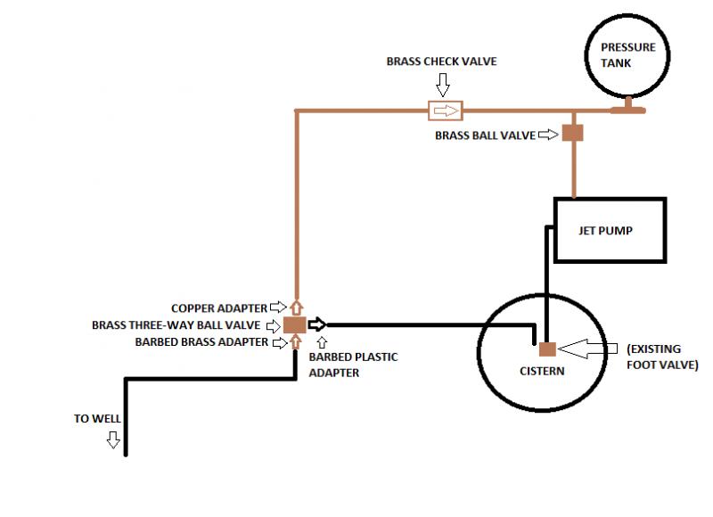

  9. #24
    DIY Junior Member prayingmantis287's Avatar
    Mar 2013
    Kendall, NY
    15
    Quote Originally Posted by ActionDave View Post
    All's good.
    I focused on the electrical side of your question. I'm confused about the plumbing side. You need the well pump to fill your pressure tank or the well pump to fill the cistern and the jet pump to fill the the pressure tank. I don't know how you can make the two independent .
    Hopefully this diagram helps visualize it. To have the water fill the cistern and the jet pump fill the pressure tank, I would turn the three way valve to pump directly into the cistern and open the ball valve near the jet pump. To have the water pumped directly to the pressure tank, I would turn the three way valve to bypass the cistern and close the ball valve near the jet pump.
    Name:  Well pump plumbing diagram.jpg

  11. #26
    Mar 2013
    Kendall, NY
    15
    Quote Originally Posted by DonL View Post
    May I ask, Exactly what is the problem that you need this mod ?
    I was confused from the original post.
    What exactly is the method to your madness ?
    I guess the main reason for doing this is that we actually don't have a problem anymore (knock on wood) which was an almost useless well. Currently, the cistern uses a float switch, but even being tethered as short as it can go it has to fill over three pressure tank cycles worth of water by the time it switches off. Another main reason is i really don't want to have chlorine in the water (would need to purchase an injection system as there currently is none. Speaking of which, thanks Dave for pointing out it doesn't need to be as concentrated as city water to still be effective.) There's also a kinda gross layer of algae coating the inside of the cistern because it's located near a window. A couple other reasons are to eliminate the need to pump the water twice (might save a bit of money on the electric after a while) and the only thing between the guest bedroom and the jet pump is a layer of sheetrock (that pump is mighty loud). One more bonus i just thought of is if the float switch ever got stuck in the on position, I might get the entire contents of the well in my house

  14. #29
    Mar 2011
    Houston, TX
    3,648
    I think I got it now.
    Why don't you just adjust the pressure switch for 50/60 ?, that would help but it will make the pump cycle more.
    Or put a flow restriction on the output of the well pump. That may be a better option.
    What controls your well pump ? Does it have a pressure switch also ?
    I guess you have it on the float switch ?
