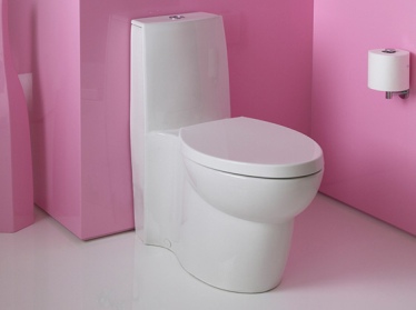

    Looking for:
    Dual flush
    One-piece
    Skirted bottom
    Elongated Seat
    Sounds like Toto is a big favorite here, but it just seems too tall for my very short family and I know I will be uncomfortable.
    Current toilet is 14.5" and I'm happy with that.
    So I'm looking for the above options in something shorter.
    I don't want to get something so obscure that it will break or no one ever heard of it, or some cheapo brand made in China, but most of these brands are all new to me so I can't tell...
    Kohler Saile sits 15" off the floor but I've read so many negative things here.
    Coroma caravelle sits 14.75" off the floor but mixed reviews, and has a "round front plus", so not sure I will be happy with the configuration.
    Fresca Delphinus sits 15.5" off the floor.
    Fresca Serina sits 15.2" off the floor.
    Ariel Monterey sits 15.6" off the floor.
    Opinions on these?
    Should I look more for a shorter seat like this?
    Thank you.
    Added Persuade
    Kohler Saile

    Just wanted to add that I looked at the Inax but it seems to be the same height as the toto - 16.5" off the floor.
    14,201
    The CST416M sits 15-1/8" off the floor.
    I've installed the Kohler Persuade, it was difficult.
    We've installed a few hundred of the Aquia bowls. It's nice to have a good floor to set it down on, with the small footprint.
    I just swung by a home in Seattle this morning, they have two of the CST416M and the one-piece MS654114MF

    There are multiple versions of the Toto Aquia, one taller than the other.
    The one Terry mentions, CST416M, is well within the height range of the esoteric ones you are discussing.
    I would recommend that one to you. Terry points out in other posts that he has sold hundreds of them with greater than 99% customer satisfaction. It doesn't get much better than that.

    The Saile is like the Persuade in how it installs. Notice how close to the wall it sets?
    And how does the water supply line up? Like the Persuade, the connection is hidden, and then it exits the bowl through a hole. You need to make sure that the shutoff location is correct for this bowl.
    It's just like the Persuade.
    The mounting bracket for the Kohler.
