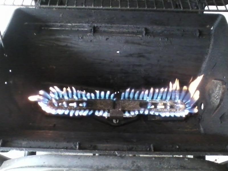

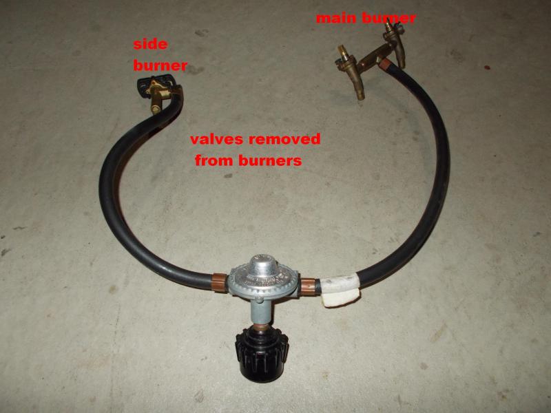

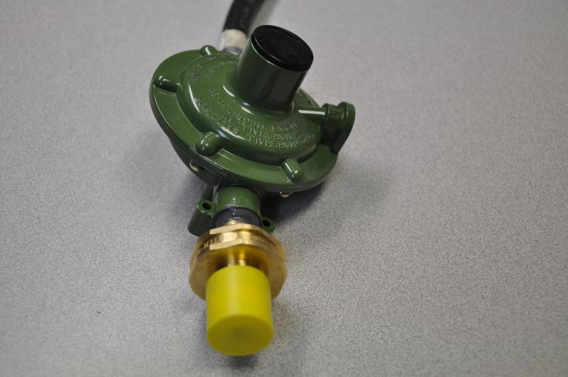

    Dont know if this belongs in this forum but will try:

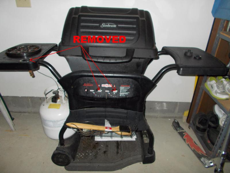

    Have an older Sunbeam propane grill with a dual main burner and one side burner.
    So three controls where:
    1- is the side burner,
    2- is the left side of the main burner and
    3- is the right side of the main burner
    If I have either 1, 2 or 3 lit, I get a full flame.
    But as soon as I have any combination of them lit, the flame diminishes big time on all.

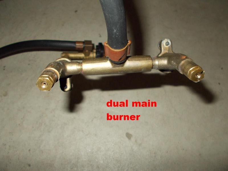

    I checked all venturis and there are no spider webs or obstructions. I even removed the valves from the burners therefore elimintating any clogs and reattached to propane tank. You can hear the decrease in the "hissing" sound when 2 of the valves are on.
    Propane tank is newly filled and propane tank operates fine on other grill.

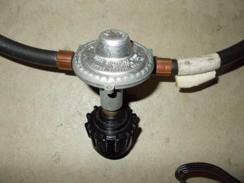

    Has anyone had any problems with a regulator going bad?

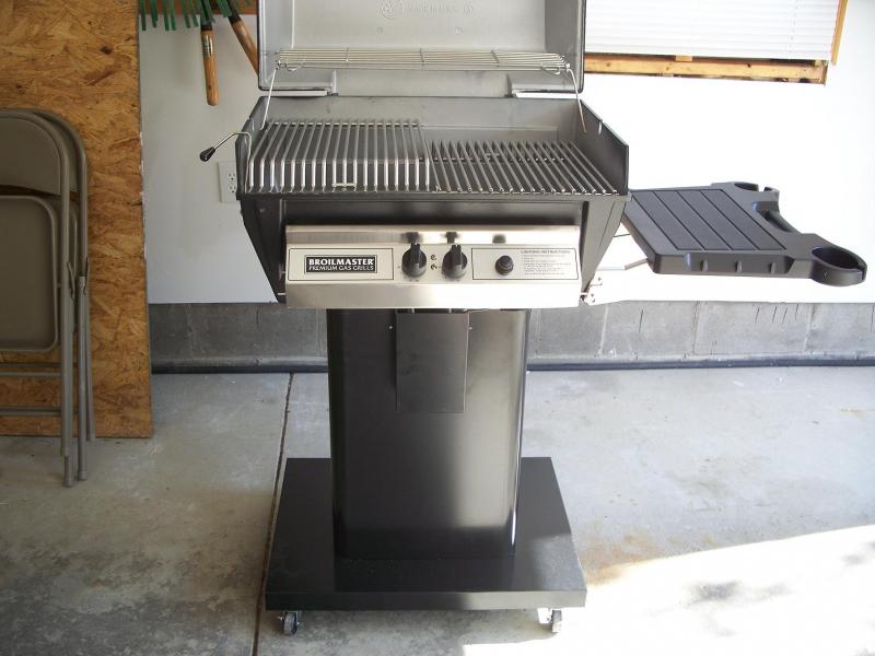

    Over the winter I was able to obtain a Broilmaster natural gas P3BLW with the bowtie burner. Going to debut it as soon as winter is done.The Sunbeam is just a backup.

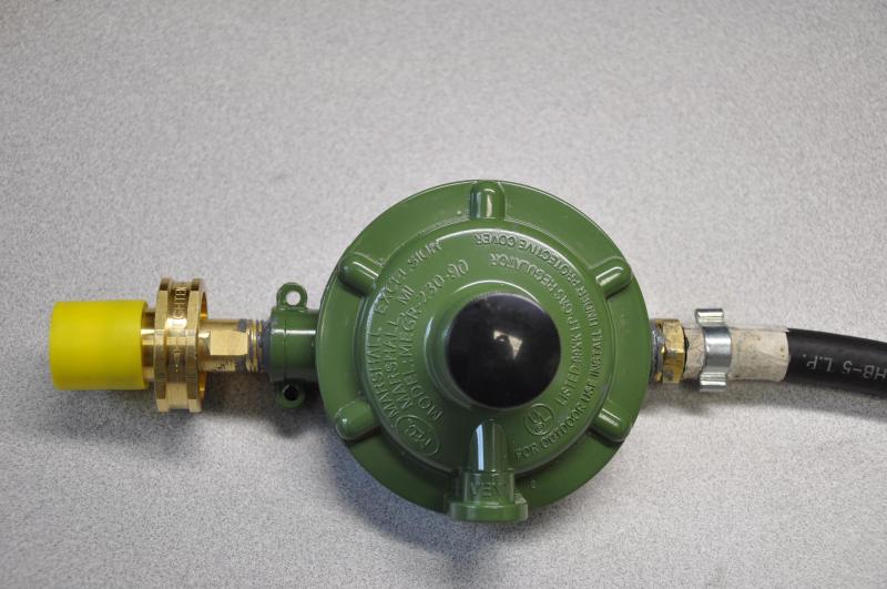

    Since EVERY burner works properly by itself the problem is NOT in the controls or orifices. You just don't have enough gas flow, and that could be due to a bad regulator or a cylinder valve that limits the flow in case of a bad leak.
    Oct 2011
    252

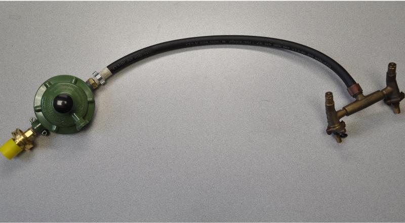

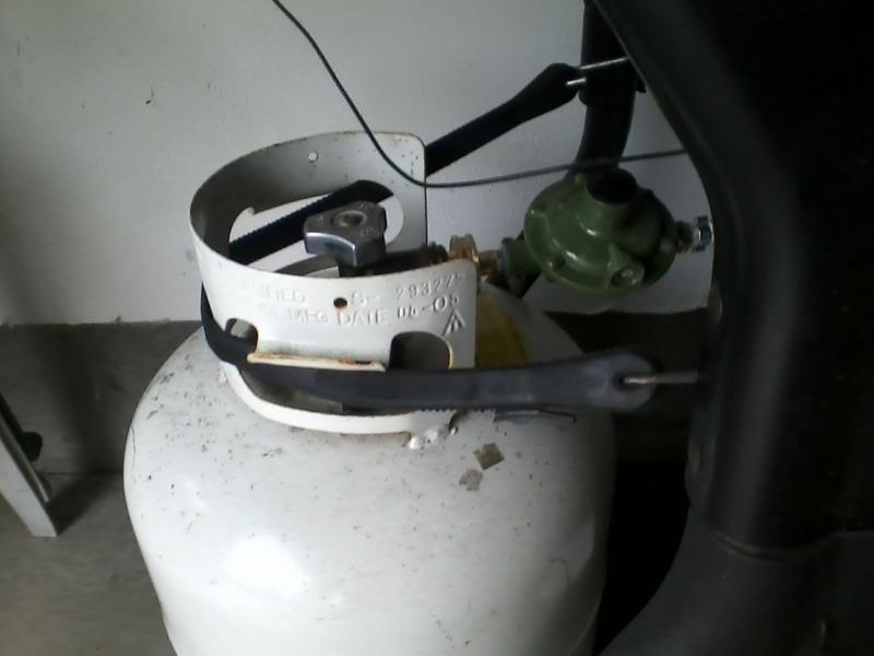

    Turned out to be the regulator. Picked one up from local gas grill house along with an oetiker clamp and a barbed connector. Burner works fine now.
    Only thing is the new regulator only has a single output so I can't use the side burner and the cylinder needs to be rotated 90 degrees an d now I need a bungee to secure it.

    That is why they make close nipples and tees.
    My grill has a wierd habbit of if I turn the bottle on too fast, I barely get a flame...even on high. What I have to do is: turn the bottle off, unhook the hose from the low pressure side of the regulator to "bleed it", reconnect the hose, open the bottle slowly, light the grill, and then I get a decent flame. Cheap Chinese junk... I've talked to other people that have the same problem...

    Quote Originally Posted by jm66208 View Post
    There is a safety mechanism in the regulator in case of a leak. You can inadvertently activate the safety device without having a gas leak. This typically occurs when you turn on your control knobs before you turn on the LP tank valve, opening the propane cylinder too fast or shutting the cylinder off while the burners are still on.
