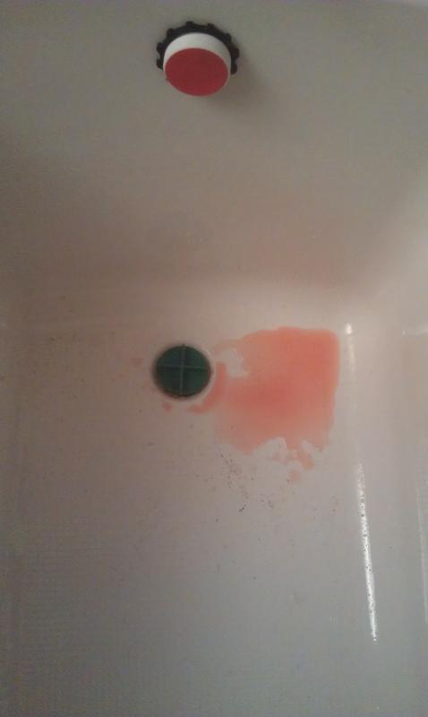

    The third tub came - same brand, different model. I had it installed, and lo and behold, it pools water in the corner. I sent pictures to the supply house, who said 'after reviewing with another associate, we don't see it as a problem, but we will support your decision either way.' I poured some red juice in the water, and the sitting water covers the entire corner from the edge of the drain to the wall of the tub. It will obviously cause issues with staining/cleanliness, and should not be this way for a $500-$600 bathtub.

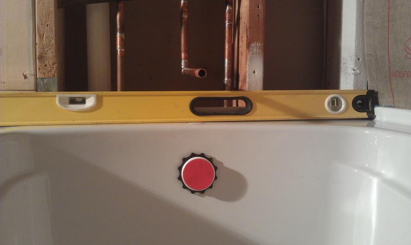

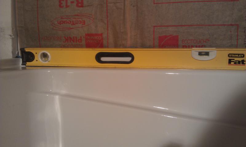

    This weekend I investigated further. The 'ledges' of the tub are not straight. The back side is, but as you go forward it seems to bow to the outside. The front ledge is completely bowed, high in the center and low at the outside edges. If the bottom follows this same profile, it is no wonder it does not drain. It does not seem feasible to try to bend the tub into a level plane - the material is very thick. Furthermore I am having the walls tiled and this will likely show up against the straight lines of the 12x24 (brick lay) tile.

    No, I am seeing that you have 3 which are terrible, and that it could have likely all been avoided by purchasing a well known name brand which has been in the market for over 100 years. If you look around the site here, I don't think you will find any argument that the best tubs are cast iron. Next down the scale are the American Standard Americast tubs, but they also have a fair share of complaints, mostly regarding creaking noises.

    Did they try to bed the tub in mortar? If that is not done carefully and with the right consistency, it could bend or warp the tub. Using spray foam could make it worse, as that stuff expands, it can exert a lot of force.
