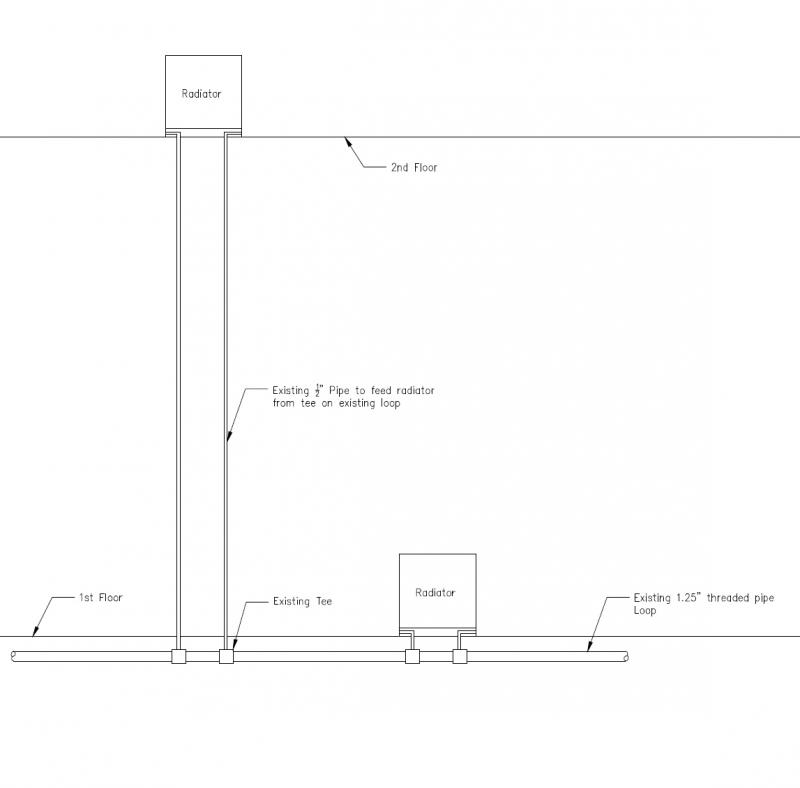

    Thank you for some good information. I guess I should have clarified that when I mentioned plugging the "tee's" that would only be for the tee's servicing the first floor radiators. I will retain the existing loop and the tee's that service the second floor radiators. I will then put the first floor radiators on a new loop with tee's, using pex, and If I understand right I could probably get away with 3/4" pex but 1" wouldn't cause any problems?
    Also you are correct the taco 007 isn't the original pump because I found a small B&G aqua colored pump, 1/12 hp I beleive floating around the garage. The previous owner must have had it changed for some reason.
    Lastly the reason for two boilers is so that eventually when this is two rental units they can have separate gas bills for heat & hotwater. (I was thinking two small boilers for heat & indirect hotwater?).
    I decided to make a quick sketch of the existing conditions for clarity. What I'm proposing is keep the existing loop for upstairs, & plug the tee's that feed the downstairs radiators. Install a new loop & tee's for the downstairs radiators which would be the same exact length as existing, in fact in would run right next to it.

    If the individual zone heat loads are low enough and the radiation sizing large enough you may be able to make it work using a condensing hot water heaters rather than boilers + indirects. The heat load calculation is critical for making those decisions.
    Mono-flow tees have little scoops/deflectors in them that are restrictive. Rather than plugging the tees, add a short bypass pipe between them, (replacing the radiator and the runs to/from the radiator) or it will end up restricting the total flow.
    To use the same radiators with the same room-to-room heat balance you may need to plumb the upper floor loop with mono-flow tees too, but I'd strongly recommend getting competent hydronic design help with this, even if it's all sweat-equity on your part for the installation end. There are variations on the theme on monoflow tee systems and I'm the furthest thing from an expert on designing with them, but done well they deliver pretty good comfort. Last thing you want to do is to have to rip it out and start over, or suffer along with a marginally functional system that could have been working GREAT for the same or less money up front.
    Start with the room-by-room heat load calculations along with the room-by-room radiator sizes, and we'll see how it all shakes out. (With wall construction type & R-values, attic R-values, and window type & U-factors, if you have them I can show you how to ball-park the heat load well enough.)
