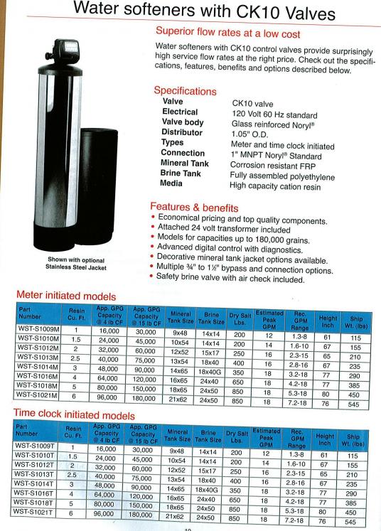

    Sigh, if I must. Here is a page from Watts catalog. I think this states it fairly clearly. Anything else I can help you with?

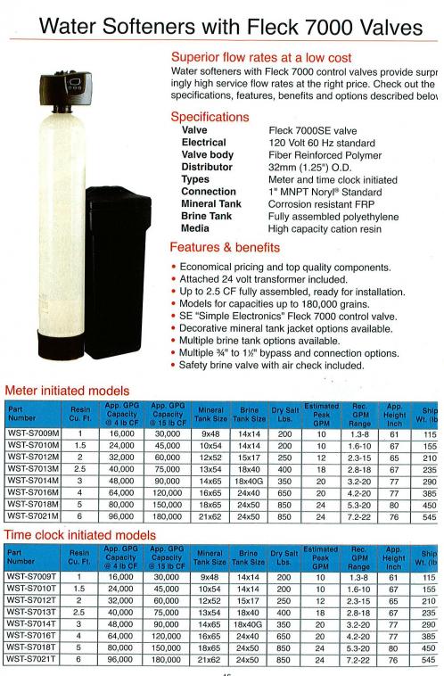

    Here is another one with the Clack info. Just like intermittent higher flows have little affect on a systems performance in residential applications, intermittent low flows have little affect as well. These numbers should be considered for very large systems. This is one reason why twin alternating systems tend to be preferred over very large tanks in residential applications.

    That info doesn't come from Fleck or Clack, it comes from Watts.
    And I see abbreviations for approximate and recommended but...
    I also know any web site or 'manufacturer' can say anything they want to about their equipment. I know that Nelsen doesn't claim the same as you stated they do and, that most all other softener 'manufacturers' don't either. Plus I sold what you are calling oversized softeners for many years without channeling problems.
    Then after all this you say: "intermittent higher flows have little affect on a systems performance in residential applications, intermittent low flows have little affect as well"....
    Now if you insist on continuing your misinformation line, show us a resin manufacturer that supports your and the Watts recommended low gpm flow claim and include your claim that channeling isn't prevented by the length of time between regenerations.
