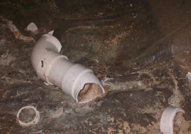

    I had recently purchased 2 as cadet 3 flowise toilets that quite working after 2 weeks so I have place an order for 2 TOTO eco drakes they are currently on back order. Well last night around 8 PM We had a small brown out both toilets shot out water and my sewage lines came apart in 6 different locations. Called an emergency plumber and he told me I had experience a powerful back flow due to no ventilation and he wants around 850$$$$ to fix. now what do I do other than replace the drains? at total I am looking at 1400 expense including 2 new totos?
    also I have live here for 6+ years and have had no problem

    Can you post some pictures of that?
    Having pipes come apart seems a bit extreme.

    Got a sinkhole under there? Being partly serious here...it would take some really strange situations to generate enough hydrostatic pressure in a drainage system that would blow the pipes apart, and lack of vents isn't one of them that I can think of unless they didn't make the joints properly. Now, if they didn't use the right cement, or failed to use any, things could 'spontaneously' come apart given the right circumstances, but it would still be tough.

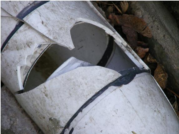

    Ok, my local Plummer Mr. Newton showed up about an hour ago and he saying the pipes were clogged and then froze and that the reason it blew back was from where I used the air force on the shopvac to blow the lines clean from outside and apparently the brittle pipe broke apart here are a couple of pictures on the broke frozen pipes.

    Now, freezing makes sense, but that usually doesn't happen even up north where it gets much colder more often because people there know about a frost line, and bury their drain (and supply) pipes deep enough so it doesn't happen! THis may have been a freakish, infrequent cold snap, but failing to bury lines deep enough can be quite catastrophic. A frozen/split water supply line could make a big sink hole and cost a bunch, too. From both a safety (from breaking them while doing normal gardening or driving over them) to cold, it makes sense to bury these things at least a couple of feet down. How deep were yours where they froze? Were they IN the building, and the heat was off, or buried?

    Lower pics seems to be abs solvent on pvc pipe with poor coverage at that looking at where coupling has blown apart. Upper pic either no primer, or they used clear.
    they were not buried at all i am in a manufactured home.
