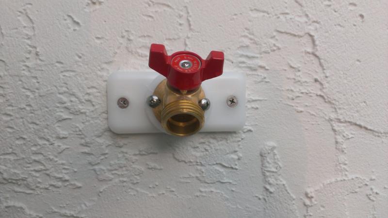

    Well, I'm King Dumbass. I used a 3/4" PVC to CPVC adapter. I then stepped the 3/4" CPVC down to 1/2" CPVC and installed a sillcock using a Quick Bibb mount. It's very secure.
    I turned on the the main and noticed a few drops. Stupid me, I forgot to cement one joint (CPVC to CPVC). I quickly turned the water off and in my haste to make this right I figured I'd use Rain-R-Shine since the pipes were wet. I got it glued together and instantly realized Rain-R-Shine is meant for PVC, not CPVC. I've read that it's hot water that's not suitable for Rain-R-Shine (this is cold water only) but I won't be able to sleep at night knowing I used the wrong cement.
    I'll have to redo it in the morning. Doh!
    Tipsy
