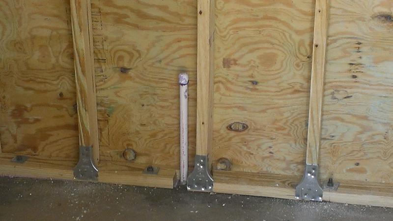

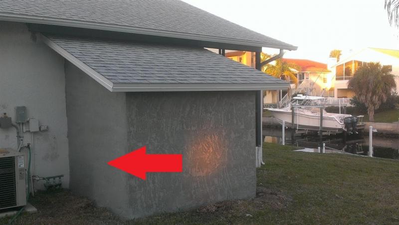

    I just built a small lean-to and had a 3/4" PVC pipe roughed-in up through the slab. I want to go through the wall (1/2" PT plywood with lathe and stucco on the exterior) to install a sillcock. I'm not sure about the best way to do this. I thought about transitioning the PVC to galvanized but decided that's probably not a good idea. I don't want to risk the PVC female adapter splitting. Should I transition to copper?
    Since PVC, galvanized, copper, etc. have virtually no "give" I'm not sure if I should attempt to have the sillcock flange rest flush against the exterior or if I should plan to have it extend two or three inches. I will place a block of wood between the stub-out and the stud so I'll have something to strap it to on the inside of the shed but I'm concerned that an errant tug on a fully extended hose could cause problems if the sillcock isn't well secured.
    Thoughts?
    TIA.

    Regular PVC is not rated for the pressure of a supply system! While there is a version of PVC designed for water supply, it looks like that is schedule 40, which is designed and tested for drainage only.
    Most silcocks are designed to be screwed to the exterior which holds the valve firmly in place. PVC becomes brittle with age and UV exposure. If it's the right type, once inside the building, you must convert to an approved pipe such as pex, cpvc, copper. If this is NYC, hopefully, you provided a means to drain the line, as in a leanto, that pipe will shatter in the winter when the water freezes making a real mess of things.

    If this were my project, I'd cut off that PVC line in the shed, bust out just enough of the floor to dig out the elbow, and then go inside and cut out the PVC from that end. This should leave you with a straight run of 3/4" pvc. Fish a 1/2" pex line through this, which will be a little challenging to make the 90 turn up into the wall, but otherwise you'll have a proper install w/o tearing out all of what you've done so far.
    If you happened to have used a long turn 90, or possibly even with a medium 90, the pex may slide right through the fitting with a little bit of lubrication on the pipe.
    You don't need 3/4" for a garden hose, the hose won't flow much more than you can get through a 1/2" anyway. But you'll have a properly done install. If there's going to be a lot of stuff shoved in and out of this shed, you might want to put some kind of sleeve, like PVC, over as much of the exposed pex as you can to protect it from damage, and UV (will break down Pex over time).

    21,382
    I can't tell from the picture...is the pvc sleeved through the slab, or is it in direct contact with the cement? The relative differences in expansion/contraction between the two materials will stress crack the pvc over time. PVC expands MUCH more with a rise in temp than concrete.

    PVC is allowed underground for cold water. Being underground keeps it in the safe range.
    If you have it above ground, it's getting warmer and loses it's strengh. I realize that a few bucks is a lot of money for someone living in Florida.
    When converting from plastic to threaded, you always have a male side for the plastic. A female plastic fitting will split.
    The hosebib should be secured to the shed.
    Piping is never strong enough for support.

    I don't know where these guys are getting their information, but PVC is PERFECTLY okay for water distribution, (MOST of houses in this area have PVC water lines from the meter to the building), but only outside the building where a failure cannot cause damage. AND sch. 40 is what is used for "pressure" water systems. You should never use metal into a female PVC adapter because ANY corrosion will create stress and crack it, while a male PVC adapter is one of the weakest fittings made and WILL crack at the thread. Use a coupling and half of a PVC nipple glued into it, then transition to a copper female adapter. From there, you would install the hose faucet just as if the whole thing was copper with the piping secured against any stress or movement.

    Thanks. I'll transition to copper and properly secure the sillcok to the wall.
    Can't say I'm exactly happy knowing the PVC should have been sleeved through the footer but there's not too much I can do about it at this point.
    Tipsy
    25,615
    Actually, according to code, it should not even BE in the footer. It should have transitioned to an "interior approved" materia, i.e., copper, CPVC, PEX, etc., l outside the building.

    Thanks. Just for my own education, that applies to outbuildings as well? This is a lean-to shed. It's against the house but not accessible from inside the house.
