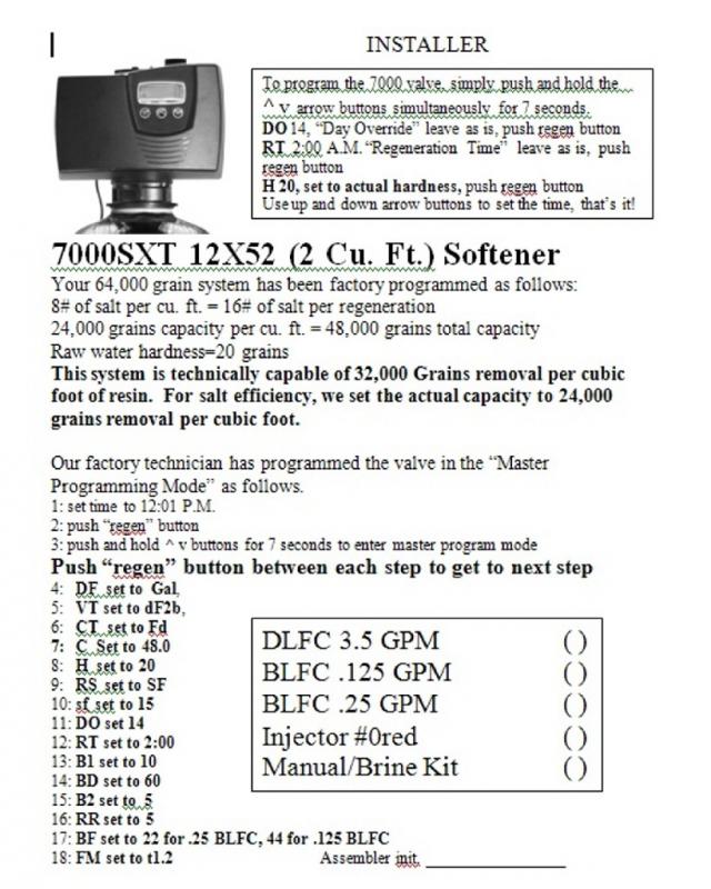

    I just wanted to thank everyone for there help.
    I did end up purchasing a system, I will let everyone know how the install goes. This is what I ended up with:
    Fleck 7000SXT 64,000 system with the 18x33 Brine Tank and a Fleck 7000 Carbon Filter as well both are in a 12x48 tank
    So I guess the next question is setting this thing. I know it's oversized for our current situation with just the 2 of us. It's not oversized for the 4 bedroom house though. So how do I set this thing to make it the most efficient for now.
    Refresher on the facts:
    Flow Rate of 12GPM
    Current People in Home: 2
    Hardness Value: 18gpg
    No Measurable Iron recorded
    Ph: 7.6
    332 ppm TDS as Measured from our Drinking Water Dispenser on the Fridge (which currently has a filter)
    The Chlorine Test did reveal that there was a small amount of Chlorine in the water, but we are aware that this can change as determined by the city.
    Thanks for all the help!
    Jan 2012
    1,707
    Name:  7000 2 email.jpg
    Be sure the BLFC and injector are the correct size, hope this helps.
