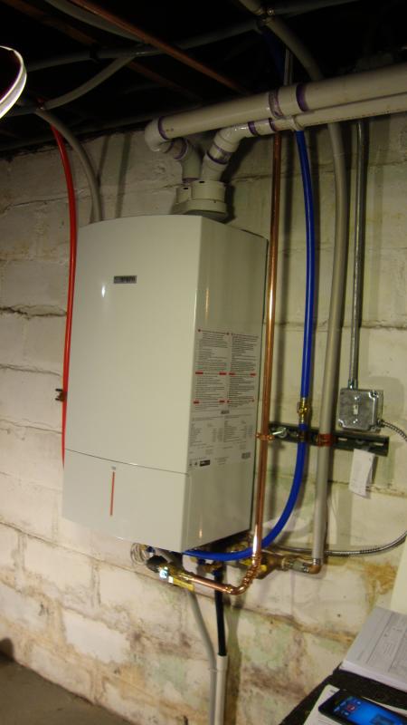

    You may want to consider a new NG condensing boiler with indirect or a combi condensing boiler with built-in domestic water heater such as the Bosch GreenStar or NTI Ti.
    With your low usage, justifying a large investment in upgraded equipment is questionable from a purely financial perspective, but with comfort, fuel usage, longevity and ecology factored in, the choices are not so straight forward. Have your contractor quote the conversion, with ODR and an indirect, but insist on two other options as well. Only the smart guys can give you choices, so which ever you choose, you will generally end up with a better technician.

    We replaced your old boiler in Minneapolis with a Bosch combi Greenstar last week!
    Every system is limited by funds. A new gas gun and indirect will do a good job as Tom suggests.
