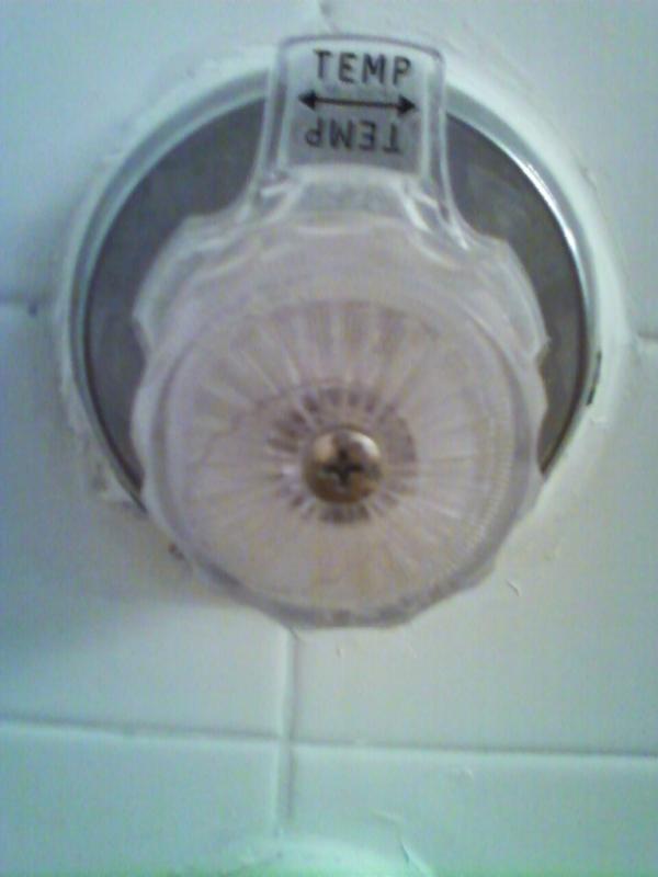

That is a Mixet. There are 3 cartridges.... regular, pre 1968; regular, post 1968; extended length. Based on the handles, I would guess you are regular, post 68. Although Mixet is long out of business, Alsons bought up the name and most hardware and supply stores still have OEM cartridges. You should take the old one with you to be sure.
