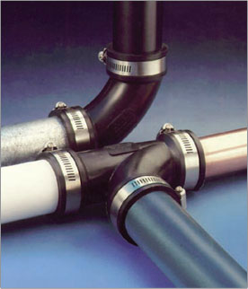

Is there any reason I cannot use a rubber T like the one pictured below. I know it will also be ugly, but it will be smaller and I could probably get away with painting it white like the pipes.
I also put a little sketch of the corner.
Here is a sketch.

Do you know if that cast iron pipe is a waste pipe? If it is a vent coming from the lower floors, you cannot put waste into it

Its not a vent pipe. It is on the bottom floor. I emailed Fernco they said the QT-200 will fit.
Any reason not to use the rubber T?
No plumbing code allows the rubber fittings.

"I" think it's a dumb idea, but I suppose you intend to use it anyway, so telling you that it is NOT the proper way to do it is useless. A PVC tee and No-Hub couplings will be EXACTLY the same size, look better, but would still NOT be proper since it appears this is a waste line, not a vent. If it is a waste line, you could be creating problems for yourself, since the new sink will NOT be vented.

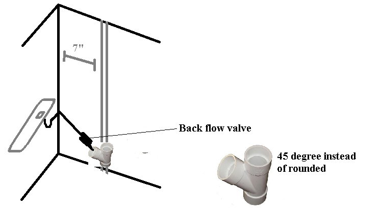

Taking that into consideration.
I have three thoughts: 1. Back flow valve?
2. More downward slope from sink rather than a horizontal run.
3. Using a 45 degree Tee instead of a rounded entry Tee
See the pic:

1) wrong
2) wrong creates S-trap code violation
3) wrong code violation....must be sanitary Tee
Still violated wet vent codes

My first instinct is to say code shmode. : )>
But if I did not have to worry about code, would a horizontal run with a back flow preventer before the sanitary trap to the trick?
Asktom
745
32
Victor, MT
A check valve won't work and the other two approaches will just compound the problem, the trap could syphon. Code and physics require a vent before you tie into the waste line. The vent would need to either go through the roof or tie into another vent above the fixture that vent serves. Sorry, but that is the deal. Is there an existing toilet in this room? If it is plumbed correctly you may be able to tie into the toilet vent.
