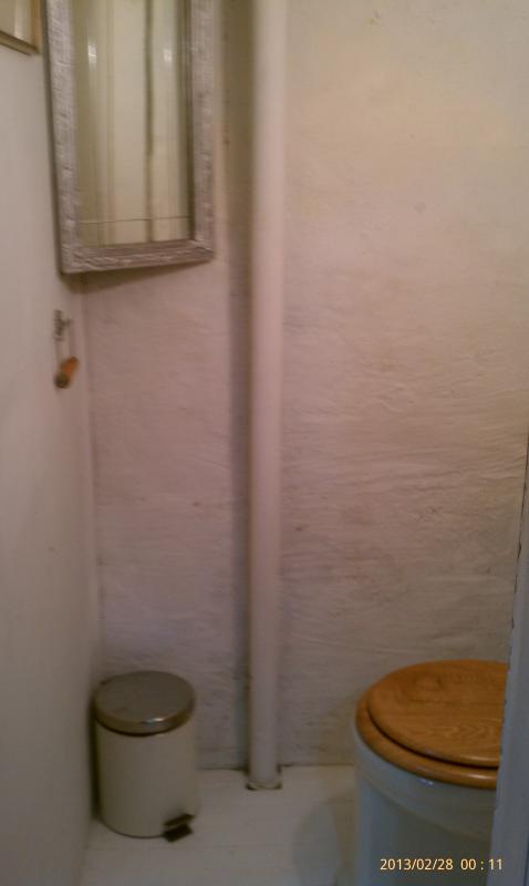

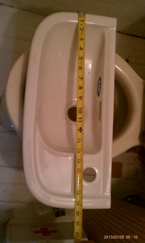

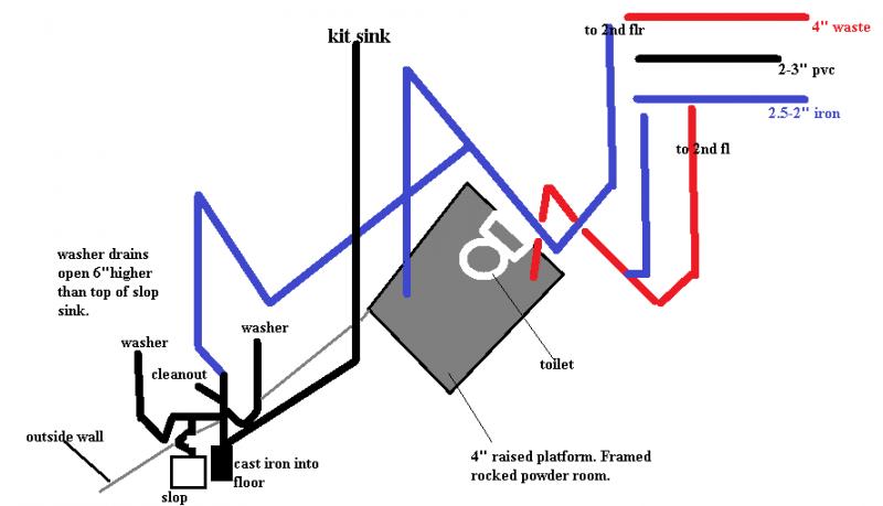

    what is there right now is really complicated. here is a sketch. Keep in mind this is only one half of what is down there. On the other side of the basement near the main cleanout there is just as much.But all that is drains directly into another 4" and no pipes connect from here to there.
    What do you think about tapping into the right side washer drain exactly 49" from where the sink drain? This is a small sink that will be for occasional use. Attached also is the existing room and the sink I want to install.

    Well, the advice went silent. That is because, while what you want to do can no doubt be done according to code, you really need a qualified person on site with eyeballs to tell you how. It is too complicated for this forum. You may also have turned people off by saying, "code schmode", or whatever it was you said. I think that is the deal.

    It's pretty clear from a recent investigation that the line right there, the blue line in the sketch is a dry vent line, not a waste line. If I tap into the washer drain line 50" to the left would that be vented?

    IF that is indeed a dry vent, then it would be vented if you tie into it at least 42" above floor. What we can't really say for sure from this info is that it is indeed a dry vent, and that that dry vent has enough fixture unit capacity left to handle another lav.
    You should probably consult with a plumber on this. See if you can find one who will take $100-150 of your money to take a look, and tell you exactly how to do it. It's worth the cost to ensure you're working safely. He'll be better able to advise you, as this is a bit too complicated for us to tell over a forum.
