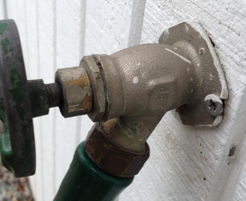

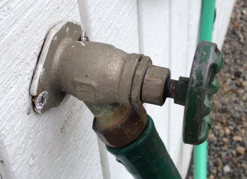

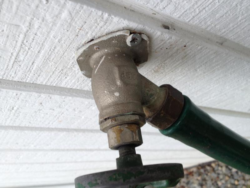

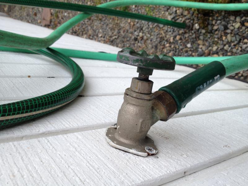

    I've heard you guys are the experts, so here I am.
    My mother has a leaky sillcock. It is protruding from the garage, but the garage was converted to an apartment and there is no access from the inside.
    She paid someone to fix it, but it started leaking again within a couple of months.
    So, I'm thinking it needs to be replaced, but I can't tell if her faucet is soldered or threaded. I removed the screws and tried to pull it from the wall, but I didn't want to pull too hard. The little bit I could see looked just like the metal on the outside.
    Can anybody help me out? If it's threaded, can I just grab a wrench and start turning?
    Thanks,
    -Joe

    There's no easy way to tell how it's attached. Just grabbing it with a wrench might break things off inside the wall. That appears to be a frost-free silcock, and if you can identify the brand, they usually have rebuild kits available. A frost free silcock generally doesn't work if there's a hose attached, and it's possible the valve has split inside if it was there when it got below freezing for awhile. You may need to tear into the wall or ceiling to get a proper view in order to replace it.
    25,655
    That is a "frostproof" sillcock and has a "long" extension going back to where it connects to the pipes. It makes no difference which it is because even if it is threaded, unless the pipe is "well fastened", you will break something if you try to unscrew it.

    There is access. It may not be easy access, it may require some demo and reconstruction, but somehow you can access it. If it is screwed into the supply line, then two wrenches will be required to prevent damage to the supply line. You must use the two wrenches to install the new faucet as well. It may be possible to rebuild the old faucet in place.

    To work, a frost-free silcock must put the working parts far enough inside so that it gets enough heat from the home to not freeze. But, as I said, the pipe from the recessed valve buried in there to the outside can retain water if you leave a hose one it, and that CAN freeze. If it does, that can both damage the valve and the extension part leading to outside. If it's split, you have no choice but to replace it. If it's leaking because of wear, if you can identify the brand, you can usually rebuilt it to as good as new without removing it.

    The valve was made by Arrowhead Brass, if you want to fix what you have you can can buy parts directly from them online. If you change the stem you should measure its length and contact them to be sure you are ordering the correct part.
