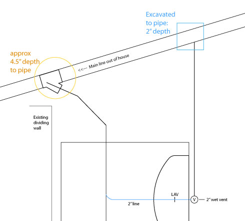

    Hey guys,
    I'm planning out the dmv for a new basement half-bath and, as you can see in the drawing below, I have the wc wet venting out via the lav. Just to note, the vent will then continue directly up to the attic where it will tie into an existing 2" that terminates above the roof.
    Got two questions:
    1. My code check book says that having a wet vent downstream from the wc isn't upc compliant. Is this the case in my layout?
    2. After vent continues on from the lav drain can I reduce down to 1 1/2" to snake up to the attic?
    Thanks

    I believe a wet vented fixture requires a larger drain pipe diameter in its wet portion and after that it could be reduced to the 1.5"
    23,545
    Run the 3" TO the lavatory install a 3x2 combo on its back, continue the 3" with an offset to the toilet. Then, put a 2x1 1/2" sanitary tee in the riser and continue 2" up for the vent. The toilet vent must be 2".

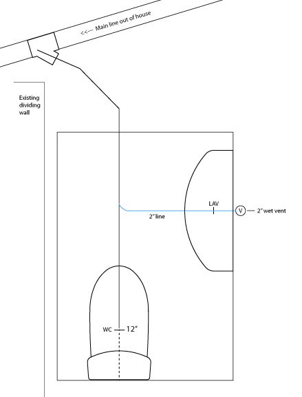

    I was going to do something like your suggestion originally, but after I found the main thru the floor(hence found it's angle and slope) figure I needed to change my strategy.
    Below's an image that shows the depths. I guess running the 3" directly from the toilet to lav then directly to 4.5" tie-in shouldn't increase the distance so much that it compromise's the correct slope I'll need.
    hj: When you say "offset to toilet" you are talking about pipe direction not the flange?
