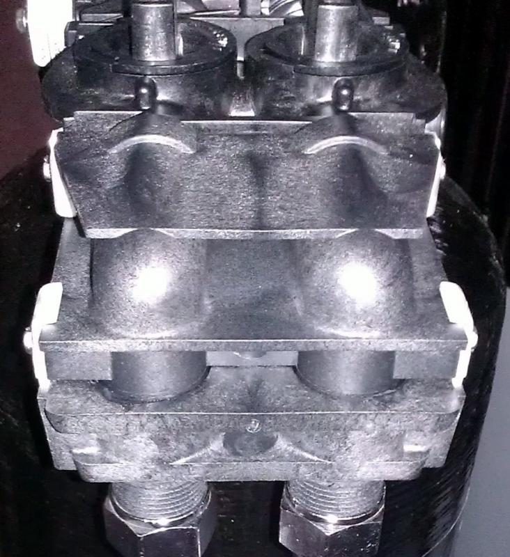

    Is there a similar 90° kit for older 2510 installations?
    Jan 2012
    1,083
    Yes, 19620-01, sorry about the bad picture. Name:  19620-01.jpg
