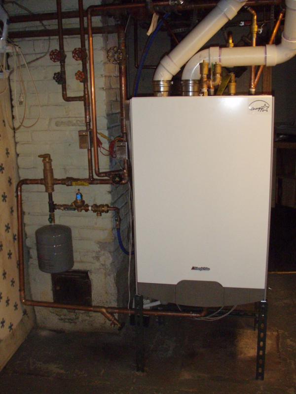

    Quote Originally Posted by Dana View Post
    The GV90+4 doesn't have sufficient internal thermal mass to keep from short-cycling on zone calls with your chopped up 160' of baseboard either. Even as a single zoned with it's thermal mass you'd be looking at 150F+ water and ZERO condensing efficiency to keep it from short cycling into an early grave, and at 3 zones it's hopeless without adding a lot of thermal mass. You might get about 85% as-used AFUE out of it, but not more.
    Seriously, try to narrow in on the true heat load, and measure the lengths of the baseboard on each zone. You need to be able to match the boiler's output at it's lowest (or only) firing rate to the smallest zone radiation reasonably, or any condensing efficiency will be eaten up in cycling losses and boiler maintenance.
    My house is multi-zoned, and radiation-limited to about 44K out at the temperature I'm running it, and it cruieses through -10F weather without losing ground. It's highly unlikely that your house is lossier than mine, and if it is, it's cost effective to fix it so that it isn't.
    What jadnashua said is dead right: "Oversizing is a big waste", but worse than a waste, it's a design problem that has to be worked around. (And there are probably dozens if not 100s of threads on this site describing the necessary workarounds when you step into the oversizing trap.)
    The Slant Fin Heat Loss calculation for my house came out to around 42K BTU loss per house. While my upstairs zone is 31,600 BTU heat loss, the downstairs is only 11,085 BTU heat loss. The upstairs fin baseboard is 100 ft 2 zones slaved into one thermostat while the downstairs fin baseboard is only 50 ft. I am concerned about inefficient short cycling. My current oil boiler short cycles frequently for the downstairs zone. I think the TT Prestige Solo 60 matches well for space heating as you fellows suggested. Now should I get the Smart 40 or opt for the Smart 50?
    Dana, you mention that the W-M GV90+4 in not appropriate. Does the W-M GV90+3 with 70K BTU work better as it is cheaper than the PTS60?

    We install and service the Triangle Tube Prestige 60 and use the TT40 in most residential applications. Stick to the plan.
    A proper heat load the first order of business. If I had to guess (thank goodness I don't) I would put my money on Dana.

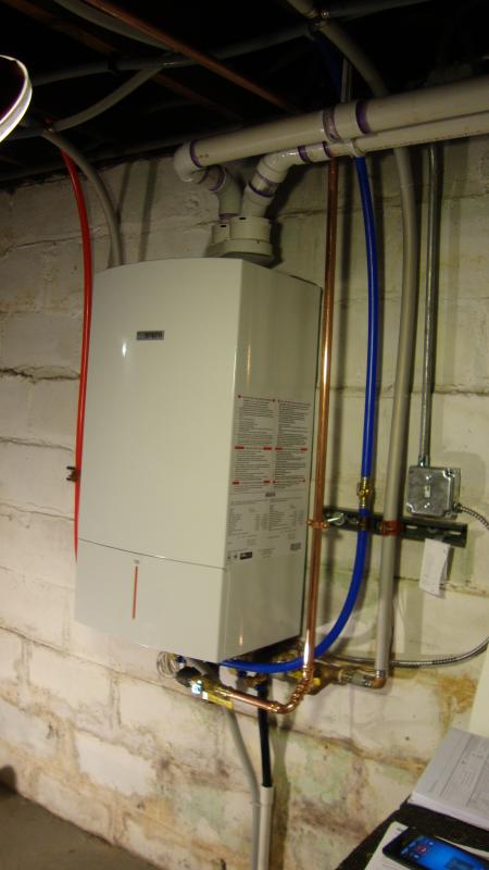

    Combi boilers and water heaters typically use a stainless steel flat plate heat exchanger to make domestic hot water on-demand and switch to space heating mode by programmed design. With DHW the boiler is typically at full fire and modulates with water draw like a tankless, but in space heating mode goes back to outdoor reset and the programmed design temperature the installer has set--if he reads and understands the installation manual.
    If you are filling a big tub the combi boiler is rarely the right appliance, but if your tub if over 50 US gallons, you would be fine with a condensing combi water heater.
    Now for fin-tube baseboard an extra caution must be taken as some of the European condensing boilers will not fire to 200°F like the old cast-iron monsters of old, nor would you want them to unless you were short of fin. It appears you are not and the Triangle is the right choice.
    By the way, you do not want to mix up the latest and greatest technology e.g. Bosch GreenStar combi or Triangle Tube Excellence with the ancient "tankless coil" that sits in an always hot cast iron fuel hog and waits for someone to open a tap (faucet for all us in the lower 48). The new combi boiler is a work of art with computers almost always smarter than they need to be only firing up when the tap is open and off when the flow stops.
    "Endless" hot water if sized, installed and programmed correctly.

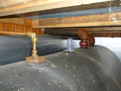

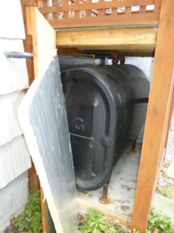

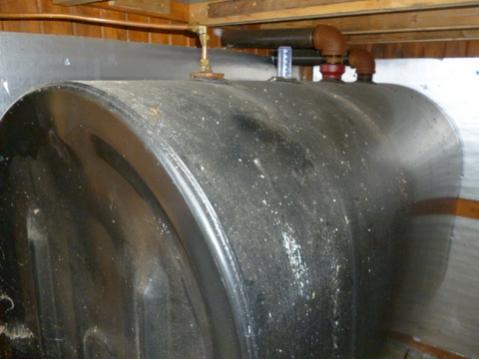

    Upon oil to gas conversion, getting rid of the 275 heating oil tank?
    The 5 year old 275 gal heating oil tank is above ground and in a shed next to the driveway. The gas contractors are quoting me anywhere from $500 to $750 to remove it from my property.
    Being that it is above ground, is it ok to put on on craigslist list to get rid of it? The previous owner had to remove the in ground tank when I bought the place 5 years ago. He had the new one installed. I figure perhaps i can sell it for $100 or at least give it away to avoid the onerous removal fees. The town only has restrictions and laws for removing in ground oil tanks. The tank looks new and i expect i to be near empty in mid April when I do the conversion. There is currently 140 gals to get me through 6 weeks in coastal CT. Thoughts?

    Listen to the Badger- oversizing the boiler is paying too much to end up with lower efficiency and a shorter boiler life!
    The simple-math model goes something like this:
    The Solo 110's min-mod output even a a higher non-condensing temperature mode is about 25,000 BTU hr or higher, (considerably higher than min-mod on the Solo-60). On a low mass stick of heat emitter like the 50' of fin-tube baseboard it would only balance at 500BTU/foot. Take a peek at the spec sheet for a random popular baseboard model. Note that it takes 160-170F average water temp (AWT) for the baseboard to get that 500BTU/foot into the room. When outdoor reset control (ODR) is calling for a lower temperature, it will definitely cycle- the only question is "how much?". You can push the temps lower a bit but not too much. As long as the burn lengths are at least a couple or three minutes long, and only a handful of burns per hour and it won't trash the boiler. But can you get it low enough to condense? Not even:
    You need an AWT of under 125F to break 88% efficiency on a mod-con, and even if you could program the hysteresis on the ODR to 20F (letting it overshoot the curve's setpoint to lengthen the burn) there is nowhere near enough thermal mass on the 50' baseboard zone to yield burns that are long enough to not eat up all the condensing efficiency in ignition & flue-purge losses, (and add a lot of wear & tear on the boiler to boot.) At an AWT of 125F you're looking at about 12K being emitted by the fin-tube, and about 28K being delivered by the boiler- it'll short-cycle, guaranteed.
    BTW: If the ~41K heat load calc was done with SlantFin Hydronic Explorer, that tool is known for having some of the highest oversizing margins out there- 25-35% over measured heat loads. Assuming that the 41-42K number is at least 1.25x reality (a pretty good assumption, 42,000/1.25= 33,600BTU/hr, which is also a credible number. With 180' of baseboard in the whole house that's under 200BTU/foot, so it looks like you could even run the thing with a fixed-output temp of 125-130F and be in condensing mode all the time, and never be cold, as long as you don't short-cycle it to an early death on zone calls. With fin-tube the output of the heat emitters has non-linearities that make output somewhat unpredictable if you tried to run a AWT of 100F, which would make tweaking in the ODR curve difficult & paradoxical, so you'd probably want to set the floor of the curve at 120F anyway. But since you'd still get design day heat into the house with 130F output it'll be a pretty short curve- still worth doing. With 50' of fin-tube and 120F out/100F return for a 110F AWT the fin tube would deliver on the order of 8000BTU/hr, or about half the min-mod output of the Solo 60. With bigger programmed hysteresis you can probably keep it from short cycling, but you may have to experiment a bit when dialing it in. Ideally you'd get at least 3 minutes of min-burn when serving the single zone, but as long as it's only of handful of burns per hour it won't much matter. If the burns are under a minute it's something of an efficiency disaster, and you'd do better to bump the temp up 5F or even 10F if that's what it takes to get at least 100-150 seconds of burn out of it at a time, even at low-low duty cycle.
    Bottom line- the TT-60 or similar will be able to work reasonably with your zoned baseboard, whereas the -110 would not- it's too big to heat your house at condensing efficiency. Any fixed-output boiler with even 40K of output would never run in condensing mode without either adding a lot of thermal mass or more radiation to the system to stop the short-cycling (buffer tanks, or more massive radiators like radiant slab floors.) Higher-mass boilers would ideally see 10 minutes of min-burn since they incur higher standby and cycling losses than low-mass mod-cons.
    There are plenty of scrap metal places that will pick it up for free.
    You may be able to have someone take it for scrap and split the money they get for it. Or take it yourself.
    If it was me, I would keep it. You never know when it may become handy. Extra Fuel is nice to have in a emergency.

    Thanks for your input, guys. Looks like the TT60 with a Smart 50 is the way to go. For the extra $200 I get a 10 gallon margin over the Smart 40 to cover the DHW.
