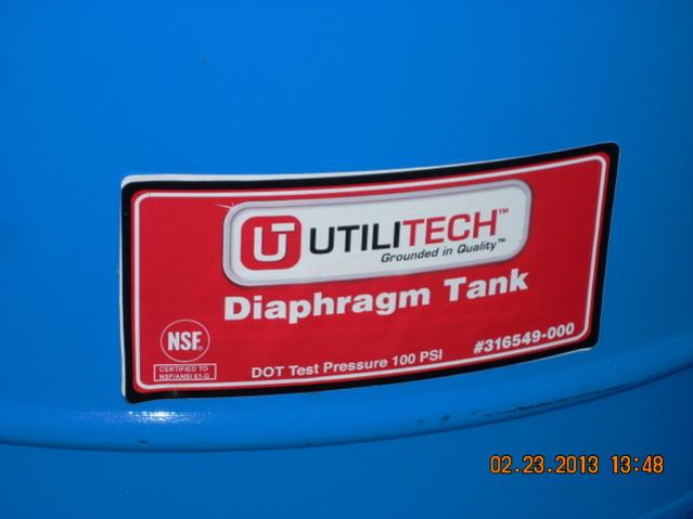

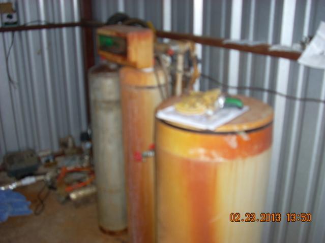

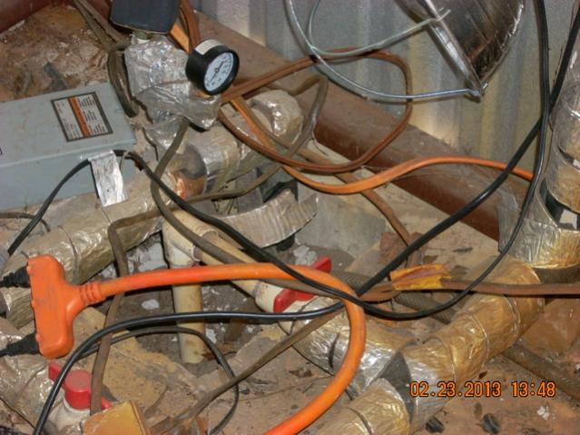

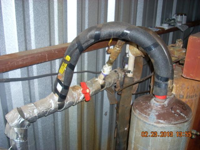

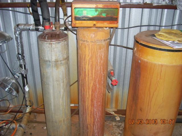

Thank you for clarification. I'll post info later this weekend as I'm going to the place on Sat. Would pictures of the system help? I believe it is a Culligan water softening system with no other filter or equipment in the configuration.

There will be 2 adults in full time residence and 2 additional adults on occasion. Plumber had water turned off to replace a toilet,so additional samples for testing were not available. I'll try next weekend. Please tell we what additional information is critical.

The system is a Culligan Mark 49. Salt set at 10 lbs. Don't know the interval of regen 7-8 days,maybe? First tank on the left has no sticker on it --filter maybe?
