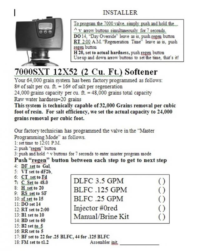

    Your settings are way off, you will have hard water the way it is programmed. Use this guide to get you started, but put the capacity down to 44 to accomodate for the gravel-less design and the lost resin.
    In order to set the reserves, etc, how many people are in your house?
    This will get you started. Let us know what your Hach 5B says your actual hardness is.

    The 32000 grins per cu. ft. is thae maximum attainable capaciy, not what the system will actually produce. If you regenerate the system at 8 pounds of salt per cubic foot, you will get 24,000 grains removal. 32,000 grains is a technical number that is rarely used for programming.
    Your 2 cu. ft. system is more realistically 48,000 grains total. You had the BLFC set to fill the brine tank with 3 gallons of water, so your actual salt usage is around 4 pounds per cubic foot, which will drop you to about 30,000 grains total capacity for the unit. Minus the lack of a gravel bed (not all of the resin is available for use) and the lost rein, your capacity will be slighly lower. You also possibly set the hardness way under what it may be (need to test with the Hach 5B to confirm) and you have a system that guarantees hard water. Reset the system to my programming recommendations and add a few gallons of water to the brine tank, run it through a regeneration and you will be just fine. Be sure to set the hardness up a couple of grains to compesate for the high TDS.
    The brine draw cycle will leave about 1-3" of water in the bottom, this is normal. The brine draw cycle should remove the water from the brine tank in about 10-20 minutes.
    On my cheat sheet, change H to the actual hardness +2.
