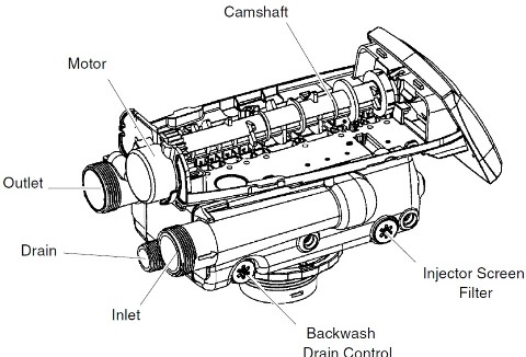

    In the parts diagram I have I don't see any reference to a drain flow control, so I'm guesing the backwash valve performs that function?
Size:  47.4 KBThis is not exactly what you have, but the design is similar. you will notice a plug that is the DLFC. It will usually have a number on it rather than the flow rate. 8 = 1.7 gpm, 9=2.2 gpm, 10=2.7 gpm, 12=3.9 gpm.
    Inside the numbered cap is a ball. Be sure the ball is in place. I would limp your system along until the new water supply comes in. You could buy another bag of resin (regular mesh) and add it to the tank so it will work much better, and it is cheap to do.
