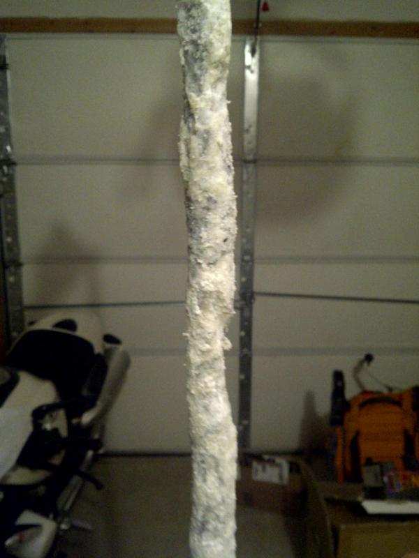

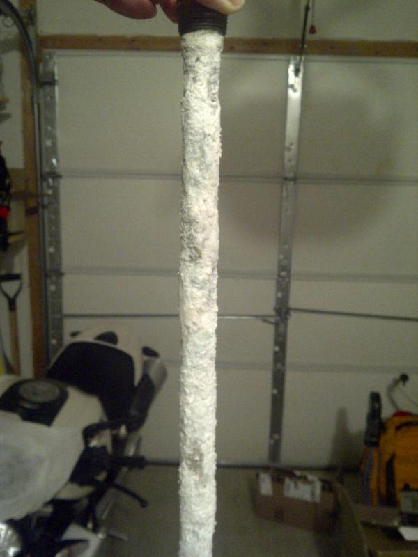

    An update from OP:
    Finally got around to work on this again yesterday. With a little more will power (and muscle), I was able to slip off the rubber seal that connects the blower unit to the 3" flue pipe to remove the blower and get access to the top of the heater. This was the least invasive way and I did not have to desolder or remove any of the pipes.
    My buddy used a ratchet with a 4 foot breaker bar while I hugged the heater tight. The breaker bar made a world of difference and required little effort to untighten the anode.
    It was a little difficult to remove the anode rod upwards, gripping with both hands but slipping because of the Calcium deposits. The rod was caked with chalky calcium (we have hard water). There were a few sections of the rod where it looks like something took a bite out of it (but not enough to break it). However, the rod seemed to be in pretty good physical condition (but for the calcium).
    One question is the original rod was at least twice as long as the replacement rod I ordered (only 16"). Should I be concerned?
    Is there a way to scrape off the calcium in the future off of this 16" rod as a maintenance task?

    By the way, here are pictures of the rod removed from the 8-year old tank.
    Name:  Anode Rod 01.jpg
    Name:  Anode Rod 02.jpg
  13. #28
    Feb 2005
    4,164
    Default so why did you change it??
    most of the rod is still intact and there is plenty of life left on it....
    I suggest that you save the rod, or maybe better yet you ought
    to re-peat this whole process and re-install that one cause it is good
    for at least another 5 years...
