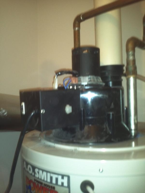

    I ordered a new aluminum anode for my 8 year old A.O. Smith Powershot 50 100 and hoped to change it yesterday. I unscrewed the 4 screws on top attaching the blower unit to the heater, removed the two clamps on the rubber transition that connects the exhaust of the blower unit (2" diameter) to a 3" white PVC tube that goes up (see pic). Name:  IMG_20130217_174949.jpg

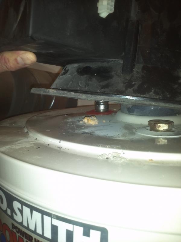

    After doing this, however, there was insufficient space to lift the blower unit over the top of the water heater because the PVC tube was fixed and in the way; it's cemented to an elbow which goes into the ceiling and there is no wiggle room. There is also a metal bracket on top of the hole in the heater. See second pic. Name:  IMG_20130217_175002.jpg
    A friend (not a plumber) suggested I temporarily remove a 3" cross-section of the PVC tube, which will free up some room. Then I would buy a 3" to 3" rubber seal to reconnect the PVC tube when I'm done.
    Looking for the forum's suggestions on how else to proceed. Have you encountered this situation where there is no room to remove the blower? Thank you in advance.

    Cutting the PVC pipe and then re-assembling with a proper PVC coupling is one option. It might also be feasible to cut one of the copper lines and remove the pipe from the heater so that the blower can move sideways enough to get at the anode rod.
    Standard plumbing rubber banded couplings are not approved for that use. The flue gas can damage some materials. An HVAC supply might have something that is, but I not aware of one.

    The first picture shows the blower flush with the top of the heater, but the second one shows the anode rod projecting above the top of the heater. Does the blower cover the anode rod, and if so how do the two fit together. There are also anode rods that screw into the heater's hot water outlet opening.
    The blower normally sits flush on top of the heater and covers the anode rod opening. If I understand your question correctly, the blower is attached to the top of the heater by four screws. The second picture shows the blower after removal of the screws and lifted up on one side; the other side can't be lifted because of the PVC pipe pushing down on it. As a result, I am unable to get enough clearance over the anode rod to remove it. Also, the replacement aluminum rod I received was only 16"... seems short to me.

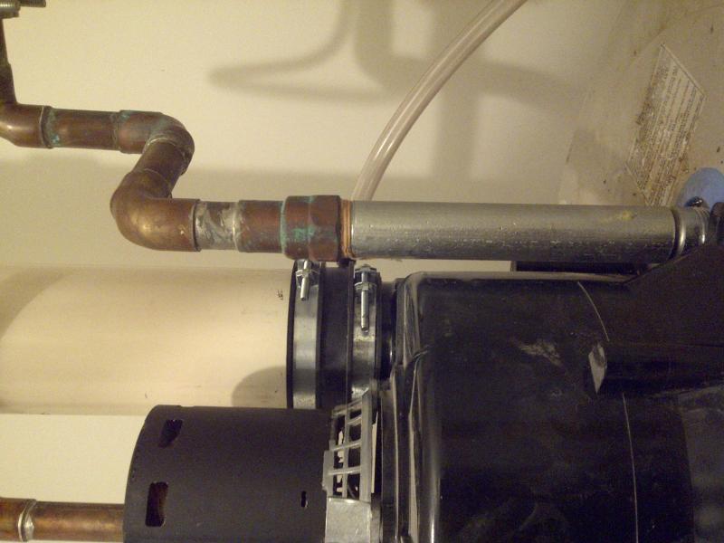

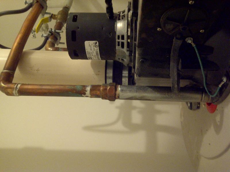

    Not being in the trade, I had to search for what a sharkbite fitting is. I think it's a good suggestion because it would allow for future accessibility to the top of the heater (in case I need to change another anode rod if the heater lasts me another 7 years). In a "why'd they do that" moment, I do not understand how the builder expected people to change the anode rods.
    The question is whether to work on the hot or cold water pipe (and which segment to remove and replace with the coupler). Here is a picture of the hot side:Name:  IMG-20130218-00102.jpg
    The hot side looks more amenable for a straight coupler. To further prolong the life of the heater, maybe I should install an additional rod under the hot water pipe (as HJ has suggested)?
    Here is a picture of the cold side: Name:  IMG-20130218-00103.jpg
    Thanks again.

    You will have to buy not only the sharkbite, but also the removal tool if you ever plan on removing it again. The pipe copper should be cut with a tubing cutter and deburred to make sure the sharkbite fits properly and is not damaged during the install. I have a feeling this is going to be an additional investment for you.
    Replacing an anode rod is a once in a lifetime experience (in the lifetime of a heater) In my opinion, this would be a perfect time for you to learn to solder, and when you are done you will have learned a useful skill. When it comes time to change the heater, knowing how to solder will make it a 1 hour job.

    Thank you; you're right that going the sharkbite route would be additional investment. I'm open to learning how to solder. Based on the pictures of the hot and cold sides, would you apply heat to the hex nut connector and screw that off? After that comes off, I'm assuming the dip tube becomes free and is able to be unscrewed from the tank.
    On the hot side, the horizontal pipe above the 90 degree elbow actually makes contact with the PVC pipe. I'm thinking I need to wrap a wet cloth around that part of the pipe so as to not melt the PVC. Thanks.
