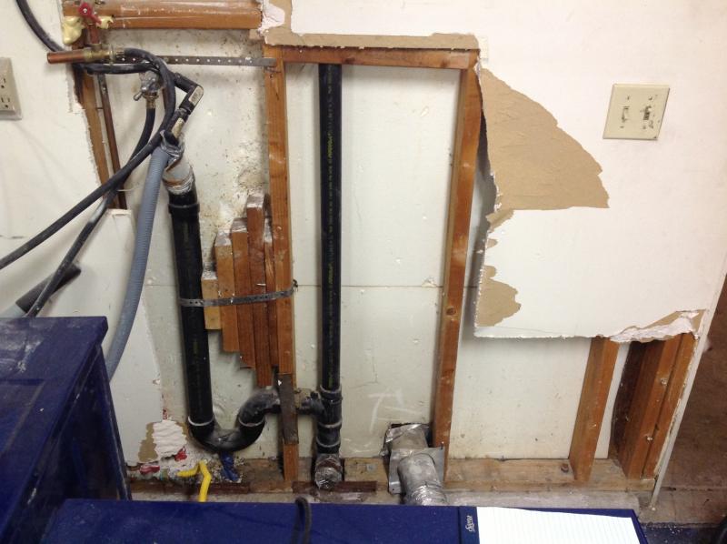

    Hey guys, I'm attempting my first DIY plumbing project.
    I found this site, and have learned quite a bit, thanks so much to everyone who gives their time & advice here.
    I'm going to put a utility sink in the garage next to the laundry.
    Here's what I got;

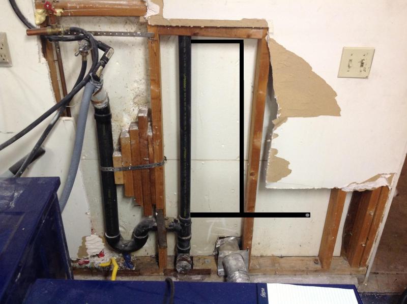

    I've seen the example picture on a few of the threads, I guess I just want a little confirmation, is this all I need to do;
    Jan 2008
    3,140
    What you have drawn in is fine as long as you install a sanitary tee above the existing one for the drain. If you are going to revent the washer, the vent take-off should be a wye and 45. The drain should be 2" and vent 1-1/2".
    You need to make sure that the sink is high enough so that when the trap is installed this will allow proper pitch to the drain.

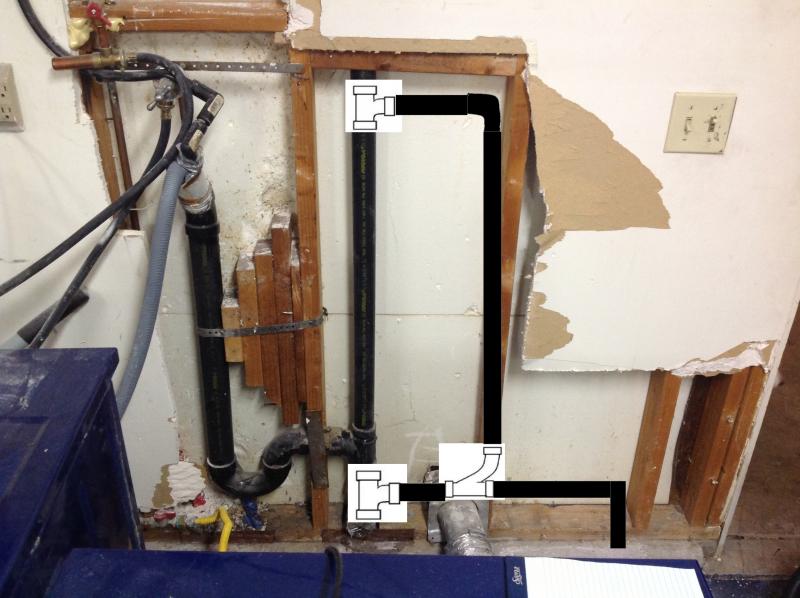

    SO do I need to go under the washer, to have my venting be correct?
    14,191
    Some codes allow the sink to wet vent over the washer, if the piping is 2"
    Or you can vent both and it passes anywhere.
    If you have the washer over the sink, then for sure they both need venting.
    Jan 2008
    3,140
    DudeJoe, the problem is that there is more to it than what you think.
    Because the washer drains a high volume of water quickly, the tee for the sink should be above the tee for the washer.
    Putting the sink tee over the washer makes it necessary to install a re-vent on the washer drain to meet code in many areas.
    An additional challenge is that the sink drain and the washer drain need to be 2" Because the existing tee for the washer is only 1-1/2 inch at the top, it that existing tee will need to be replaced with one that is 2" at all 3 ports.
    You are going to need to cut out the existing tee and laundry drain and start fresh.
    Don't cut off too much or you wont have anything to connect to, and/or the washer trap will be on the floor.

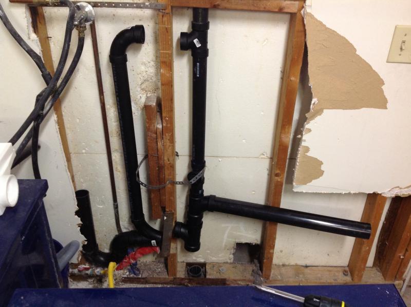

    Thanks again for all the help everyone.
    Here is what I've ended up with before glueing and and going through the studs.
    The washer drain is going to be higher, I haven't figured out where I'm putting the outlet box yet, other that that, how am I looking.

    I'll let the real pros like Terry answer for sure, but what you have there looks all right to me. Make sure you get your full standpipe height on that washer drain, but you already mentioned that you know you need to do that.
    14,191
    What you have there now will work, as long as the standpipe on the washer is taller. Change that and you can go ahead and glue it up.
    Max trap arm length before vent
    1.5" = 42"
    2.0" = 60"
    You can pretty much use a medium 90 anywhere except on waste going from vertical to horizontal.
    or horizontal to horizontal. Horizontal to horizontal needs a long turn. (edit)
    The long sweep on the vent is fine though.
    I quit stocking "vent" 90's with my fittings. Medium 90's can be used more places and they cost less.

    Looking good.
    A minor detail but the horizontal section on the re-vent should be at least 6" higher than the top of the standpipe when you glue it up.
