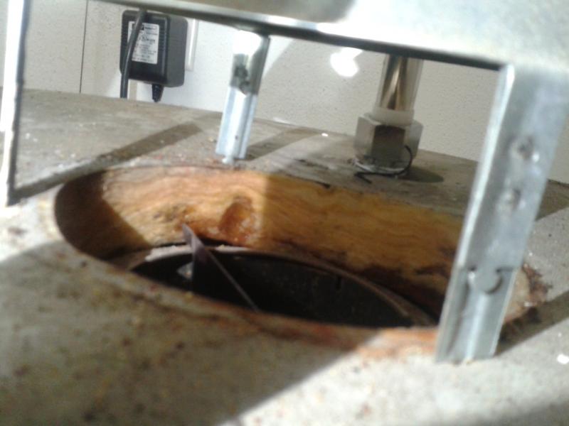

    So I did so more snooping around the unit. The only thing suspicious I found was some rust and wetness around the top of the tank. There is a couple of inches from the top of the tank to the vent, and I attached a picture of the area.
    As you can see, I stuck my finger into the insulation. The insulation is moist, and wetter closer to the tank (as shown in the picture). There also appears to be some rusting near the top of the tank (below the insulation, not the top of the exterior).
    Does this tell you guys anything (leak vs condensation)?
    Has it rained hard lately? Could be a leak coming down the flue. I have found that before.

    Rained pretty hard the day I discovered the leak in the tank. But that was a couple of days ago. The insulation is still quite wet, as you can see.

    The T&P valve is a safety, emergency use valve. When it gets opened regularly, it's best to first find the reason why, fix that, then replace the valve. The manufacturers all state you should test the valve once a year. This is to ensure it CAN open, should it need to.
    On the expansion tank, it should nominally be mostly filled with air. If you tap on it and it thuds everywhere, it is shot, and needs replacement. They don't last forever.
    A T&P valve opens either when the pressure exceeds 150#, or the temp exceeds (usually) 200-degrees or so. A failed expansion tank in a closed system can easily exceed 150# if the T&P isn't working, and will discharge some water when it opens at 150#.
    Excessive pressure cycling from a failed expansion tank can stress the lining of a WH and could be the straw that breaks the camel's back, so to speak, on an old one. It isn't great on washing machine hoses or faucet supply lines, either.

    Once it gets soaked it would take a while to dry.
