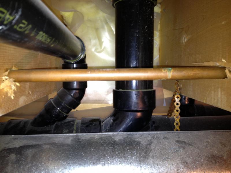

    Hi all. I need to tee a dry vent into an existing 3" vent stack just below the attic but there are fittings above and below where I need to tee in so i can't separate the pipe to fit the tee in. I found something on a UK site called a strap-on boss but I've never seen anything like that here; basically just drill into the pipe and strap the tee on.
    Since there's no waste in this tee, is there something available/allowed here?

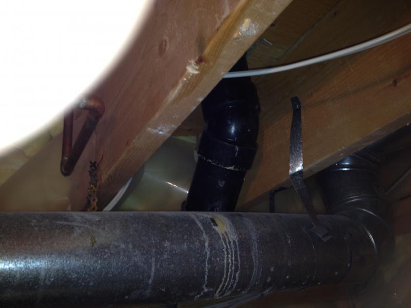

    Here's a couple of pictures. In the left picture, the main stack is shown going up through the attic. The horizontal portion is the waste from a toilet that comes down from about four feet to the right. This is shown in the second picture. The 1-1/2" pipe to the right (barely in view) is a vent from the basement that vents a laundry tub and washing machine and, possibly, a future floor drain. This ties into the stack a few feet above this picture.
    The 1-1/2" pipe to the left is a shower drain that ties into the waste line and goes down to the basement.
    I need to tee a vent into the stack in the first picture. There is about 8" there but I cant pull the vent down or push up because of the existing fittings.
    My plumber wants to cut the horizontal waste line to the left and right and put a couple of flex connectors there but that sounds like waste could get hung up there.
    My thought was to cut the shower line to the left, and the 45 coming down from the toilet (shown in the second pic) and pull the line down enough to get a fitting in. Then ABS couplings to fix the shower and toilet. I can't use the existing vent from the basement because I'm adding 4 fixtures down there and need a separate vent line.

    Let me start by saying that I'm not clear exactly what I am seeing in the pictures.
    If the toilet waste is coming in from the right, any tee you install there would be below the flood rim of the fixtures served by the vent, which is not acceptable.

    I think you're clear on what you are seeing. The vent for the toilet on the right joins the stack way up in the attic, so well above the toilet.
    The vent I am adding will be from basement fixtures but, you're correct, this tee-in will be below the 2nd floor toilet. What you are looking at are the joists for the second floor.
    This is where the plumber was going to tee in but I didn't like the way he was going to do it with the flex connectors (Fernco) and was trying to find another way.
    Now you have got me concerned.....
    Does the vent from the basement fixtures have to be above 2nd floor flood rims?
