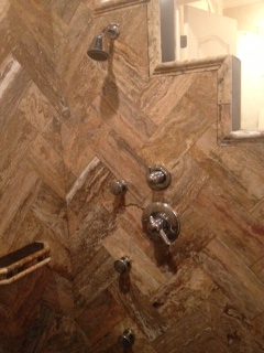

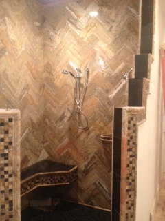

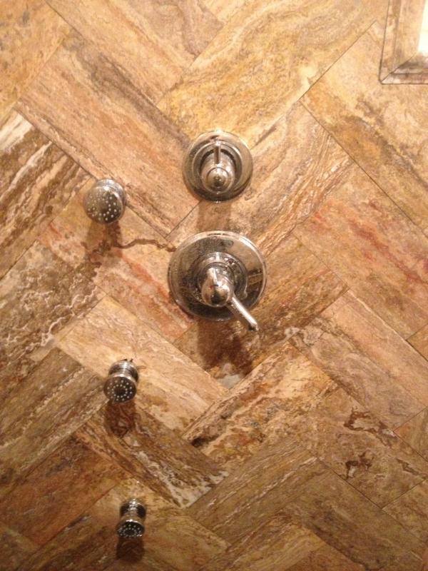

    Your using the 5gpm in the wrong way. Intermittent use is fine to exceed the 5gpm. Hose Bibbs often exceeds the 5gpm limit without ill effects because its not ran all day everyday.
    Delta faucet co rough valve will accept several different cartridges. If you use the T17253 cartridge you will get about 6.8 GPM.......if you use the T17T253 cartridge you get about 9GPM. The valve has 1/2" inlets and outlets. Check for yurself. Its within their frequently asked questions of custom showers.
    Copper and pex is sized the same way.......pex makes up for the insert fittings by using less fittings in the system. The walls of pex do not build scale like copper either.
    The internet and books usually do not tell the whole story. After about 30 years you tend to know fact from fiction.
    Thats a Delta system that runs two different functions at once in any combination. The bodysprays run 2.0 gpm @80 psi. The owner loves it and it soaks you.
