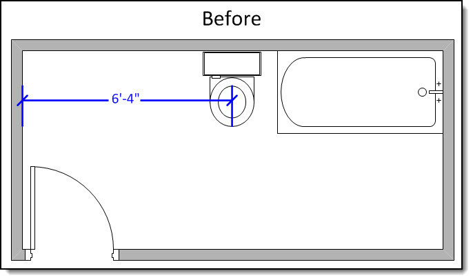

    I'm converting a single bath room into two smaller baths. I'd prefer to avoid having to do any demolition of the concrete floor. I'm building the wall between the two rooms, so I can do whatever I want with it. The new wall happens to line up with where the exiting toilet drain is.

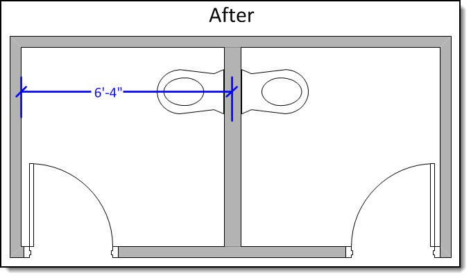

    So, I'm wondering if I used two wall-mount rear-discharge type toilets, would it be possible to have them both discharge into the exiting toilet drain if I centered the wall directly over the drain? Seems a little nuts, I know.... but I was thinking I might be able to adapt two in-wall tanks, mounted side-by-side inside the wall to provide water to each toilet. Or if that's too complicated, I could opt for wall-hung, back-outlet toilet models that have the tank on the wall, like the American Standard Glenwall .

    Would there be a way to configure the plumbing connections for both toilets to the single drain? Can someone tell me if this is even remotely possible? Here's rough idea...
    19,200
    If you research a little, you'll find some discussions about back-to-back toilet problems when the proper configuration is not done. Today's toilets flush MUCH faster than the old ones, and the waste from one can skip over into the opposite one unless the layout is not done VERY carefully. You need to also consider that the carriers for these toilets, especially back-to-back would require the wall to be VERY thick, and take up a bunch of room for your two small bathrooms. So, could it be done? WIth a thick enough wall, yes. Is it really practical? Maybe not. Would tearing up the concrete and replacing the fittings for two toilets work out probably better? I think so. Be interesting to see what I may have missed in other (hopefully) commenters thoughts.

    If there's a 12" rough-in on the original toilet, then he's only going to have 12" from center to wall on each of his back-to-back toilets. If he needs a permit (and you would where I am if you are erecting a wall and doing plumbing), he's going to fail the inspection for not being 15" from centerline to the wall on the lateral requirement.

    It's doable. You will be breaking concrete though. How much is yet to be discovered. I see that you've already drawn in the thicker wall that the wall hung bowls will need. If this is handicap, then the centerline to wall will be 18"
    I've replaced old gravity wall-hung bowls with A/S Glenwalls on the back to back fittings. It works. Many commercial bowls are done that way with cast iron carriers.
    23,517
    Use a back to back resiidental wall hung carrier and two Glenwall toilets. The wall will have to be 8 1'2"minimum finish to finsih, but can be greater if necesary.

    SHeesh...I said it was doable, but at the cost of a much thicker wall. Easier, and lots more choices of toilets, would be to tear up the concrete and create the two flanges for regular floor mounted, stock, 12" rough-in toilets.
