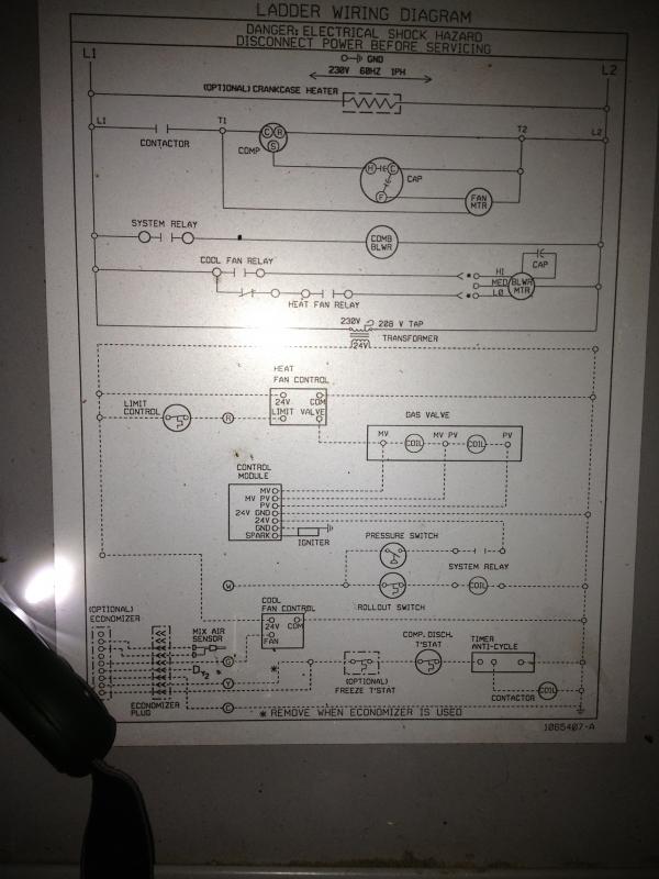

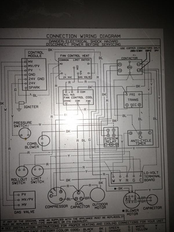

    The induction blower nor the gas or burner comes on. There is 210 coming out of both legs of the motor, yet its not running. I disconneted the second leg from the relay and it still has voltage. Its running through the motor from leg one. Is this normal?
    I tested the pressure switch. Its good. I took the relay apart and cleaned it up, but its not doing nothen. I tryed jumping some of the contacts to see if the motor would start, no go. I can jump the burner and it'll turn on. I tryed jumping it at the control panal X Y R G C and only the big blower will start.Name:  024.jpg
Size:  83.0 KBName:  025.jpg
Size:  59.5 KB Any more advice?

    Reading 220ish from each leg of the motor to ground ( or neutral ) indicates that no current is flowing through the motor. One side of the line is getting there, and there is an open circuit in the other side which should complete the path. Things that can be open are the system relay, and possibly the limit switch and rollout switch.
    If you connect a meter ACROSS the motor ( one meter lead on each wire) a reading of 220 indicates motor has voltage applied and if not turning it is bad. If the reading is zero, then you have an open circuit as I mentioned.
