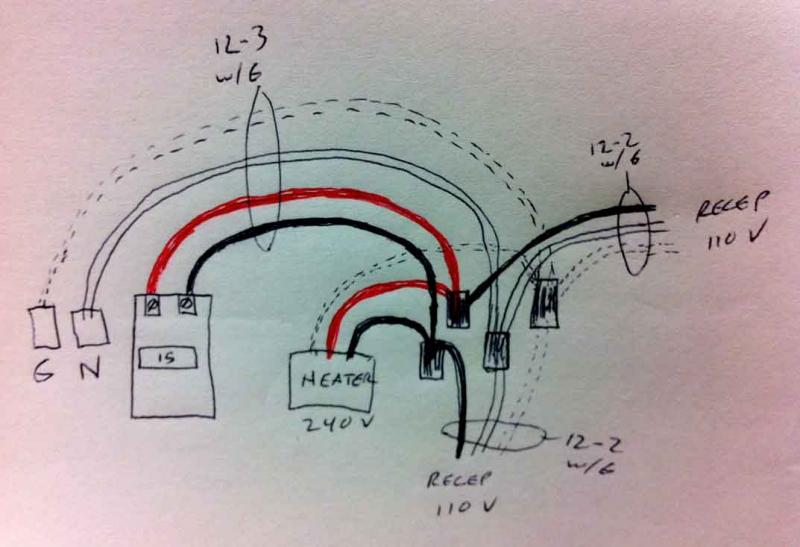

    I tried to draw what I think HJ meant, and I wanted to see if this is what you had in mind:

    23,540
    Yes, as long it is a 15 or 20 amp breaker.
