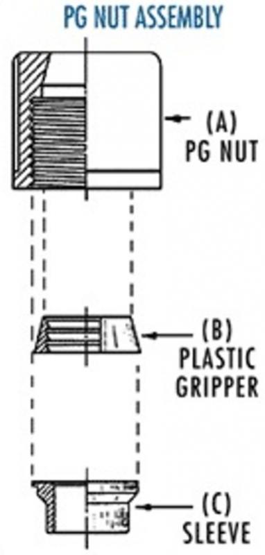

    I would also check the brine line. Even the slightest drip or leak will cause the system to not draw brine. It is like a straw with a hole in it. Removes and Check and tighten the Jaco style brine fitting on the brine line, both in the salt tank and at the valve. There is also another nut like this in the brine tank below the safety float assembly. Any leak on these fittings will cause the system to not draw brine. If you put the system into brine draw, you can remove the brine line to see if the valve is creating adequate suction. A restricted drain line is another common cause of poor brine draw.

    Thank you very much. After checking the suggestions, I removed the drain plug and ran a cycle. It's currently running correctly. The old Eccowater one cabinet system was pumped up the wall, into the attic and drilled into an overhead sewer pipe to go out to the septic. It appears that the new unit is not able to properly discharge that way currently. Options? The unit is outside in the backyard and was an addition to the house. The first unit looks like they discharged into the lawn under the sidewalk. The second unit was reworked and piped up the wall as described. Those are basically my choices. 1. Pump the disharge into the edge of the lawn or 2. Make the discharge up the wall work. The discharge up the wall is 3/8?? Smaller than was is coming off the Clack. Anyone have a suggested solution based on the information presented? Thanks for any suggestions. Jay
