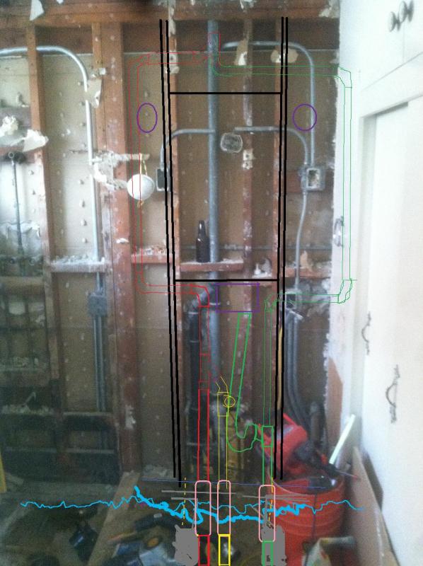

    hows this?
    green is washer @ 2'
    green reduces at vent to 1 1/2 to keep wood intact better
    trap slightly bent inward so sink stub can 45 a little to get closer to center because of the exposed finish plumbing
    green1 1/2 vent goes behind closest stud cavity to make room for sconce lights
    yellow is ran 1 1/2 because it is only bath sink & i could use the space , has clean out behind
    red is vent for shower , reduces to 1 1/2 @ y for same reason as green , will prob take it behind stud on its side to fit sconce
    black is new framing , might double up on side 2x4
    purple sconce light & elect box will drop down & all else ran romex
    pink pipe wrap
    grey rebar & possible peir reinforce
    blue thin old footing blue thick repair
    this work? now for the waste
    & yes i know copper will be a bitch but it will work

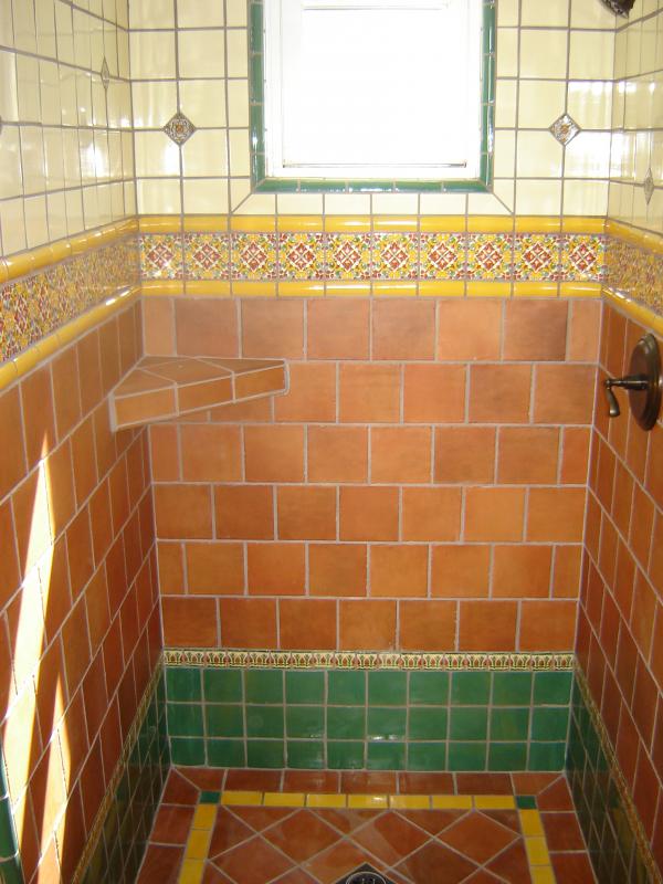

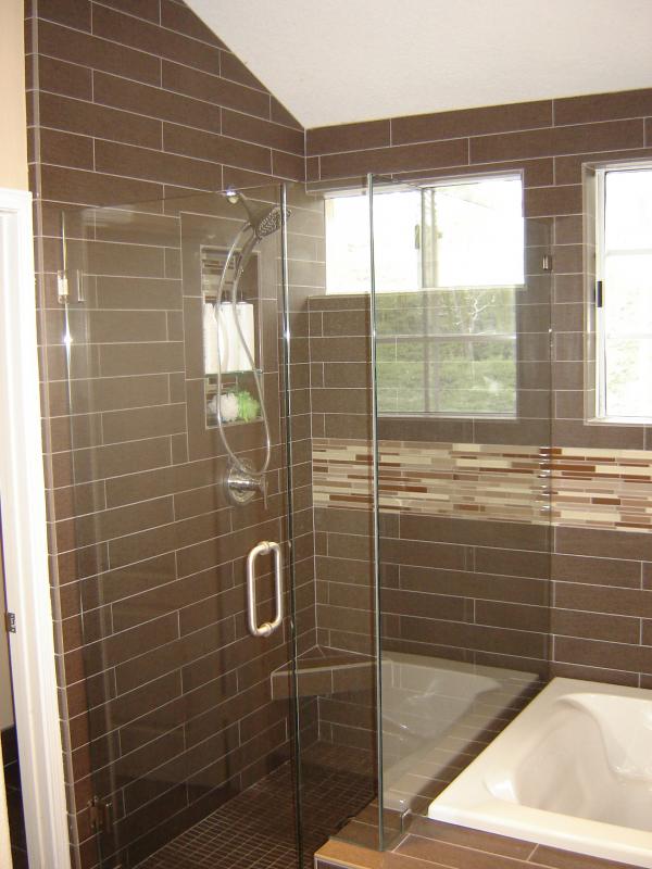

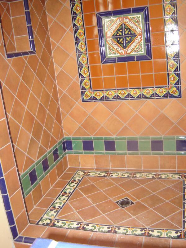

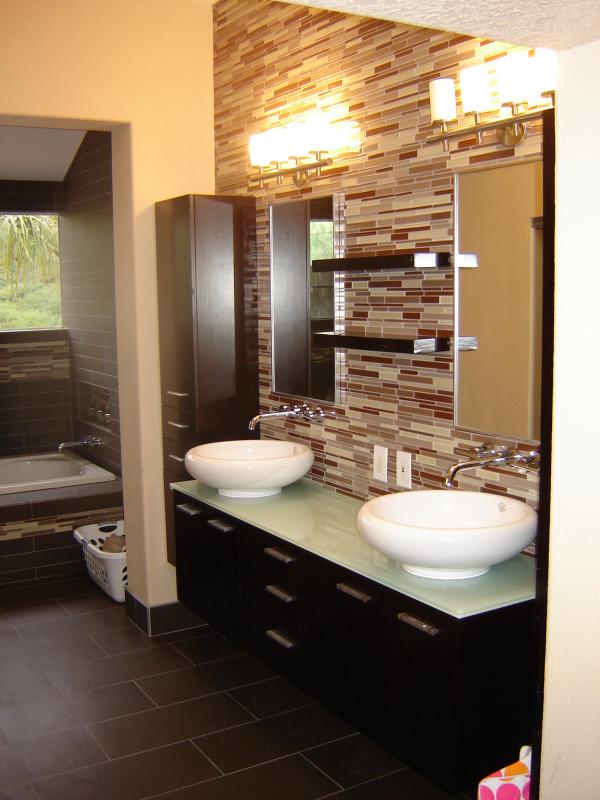

    fyi heres a few of my most recent jobs
  4. #19
    In the Trades Tileman4's Avatar
    Feb 2013
    So California
    36
    what builder / tradesmen / inspector let middle pic fly?i re run all cop and vents for this & all my others

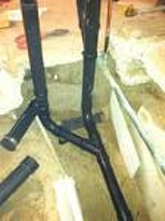

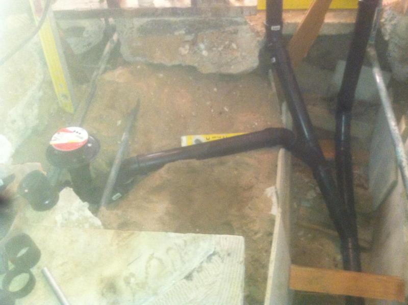

    ok so after taking a break to do another job im back and offer up my sincere apologies for any arrogant remarks, i came at you guys looking for a quick answer to a trade that takes years to understand like my own well after many hours ( 20+ !!!!!) of researching codes i came up with this.....
    now the shower to be centered needs a deep drop before trap for wier to clear pipes so getting a wye vertical branch off that main 2" was a no go i was gonna use combi but heard the san tee was proper to allow vent to work
    not sure if i can split horizonal branch like this but moving it over far enough left is no easy task
    all fixture will have own 2" vent to tie above didnt want to start that considering i need to pour footing & frame in with out hacking up studs
    also i decided to doulbe up wall to 2x8 so give room for all be in wall
    i humbly ask for any critic as i have almost gave up a few times
    thank you

    The last set of pictures are too small for me to see.
    You can have 800 pixels or smaller.
    The washer and tub need 2" for the waste portion and 1.5" for the vents
    The tub can use a 1.5" trap and trap arm after the vent.
    A shower needs 2" and 1.5" for the vent.
    The lav can be 1-1/4"
    Nobody really has that, so we run that in 1.5"
    It looks like you're doing that.
    If it's on the vertical, then a santee for venting, or a double fixture cross
    If it's vented on the horizontal, then a wye fitting for the vent.
    Offsetting the washer standpipe after the p-trap is fine.
    I like to use shutoffs with hammer arrestors for the washer box.
    The job pictures above look fantastic !

    The first one would be to go to a plumbing school for 3 years to learn how to do plumbing, then do the job. The second one would be for you to call a plumber. The third on is that the pictures are so confusing I do not even know what they are showing, but they are absolutely no help as far as designing a system is concerned. Fourth, clean up the pictures. We do NOT have to know you are using "street 45s", or "sleeved 2 inch" for example. The "middle picture" was never inspected and it was probably done by some DIYer or handyman. Doing pretty tile work is NOT the same as doing "pretty" plumbing work, nor does plumbing swimming pools make someone a plumber.

    this was one idea fyi i am lowering the pan so i can use 1x4 for damn thats why drain so low

    Quote Originally Posted by Tileman4 View Post
    but i thought the whole joint was a prob waiting to happen
    didnt know how to branch horizontal , i know combi but then w long sweep & long sweep vert just to move over a bit? ive been told that y on its back has to have that 45 on the arm

    and this i was more fond of but hj said no go ...... and i suck & and im not pretty guess my pops sucks too i dunno
    this looked like it had as little areas to clog & all units have vent that only tie in near ceiling all in 2 "
