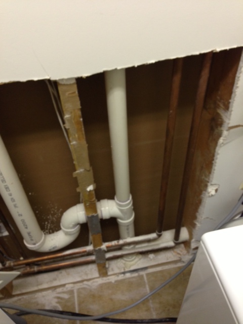

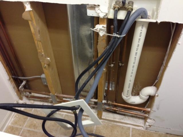

    I want to install a utility sink in my laundry room utilizing the same drain/vent Name:  Vent 1.jpg
Size:  37.6 KBName:  vent 2.JPG
Size:  89.8 KBas what the washing machine uses now.
    Current setup: Washing machine
    enters into a drain, goes through a p-trap, then that connects to the drain/vent pipe from the left side. There is also a connecting drain pipe from an upstairs bathroom that you could see near the floor (in the picture) that taps into the drain/vent.
    What I want to do: I want to install a sink on the left side also and run the drain along side the drywall and turn it 180 degrees and enter the same drain/vent used for the washing machine from the right side. I figured turning a pipe 180 degrees isn't a problem, so long as I have enough slope in the drain pipe. (But if there's an easier way, I'm open to ideas)
    Problem: In a perfect world, I would be able to use a double Y connection on the drain/vent (one for the washer and one for the dryer), however, the current connection for the washer is to high on the vent, so I would need to bring the utility sinks
    connection below the connection of the washer on that same drain/vent. Does this cause a "venting issue"? Any other ideas? Thanks!

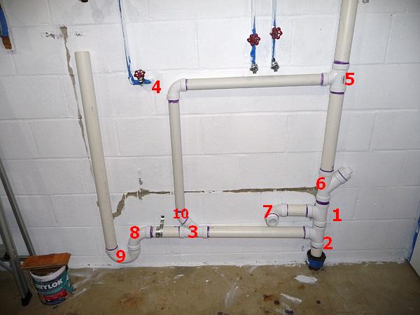

    Have no idea what you mean by wanting to run sink drain along wall the turn 180 in to stack.
    There are many laundry tub adding threads on the site.
    Here is a photo from one of them. Fitting #7 is for the sink
    http://www.terrylove.com/forums/show...d-advice/page4

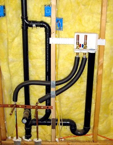

    Heres another photo of a setup
