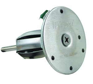

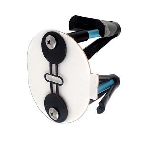

    I'll second safety grab bars. I just put a couple into my mother's tub/shower for her. If you don't have blocking where you need to install them, I've found that www.wingits.com fasteners work really well. I've used them now three times, and have been impressed. If you get their tile drill bit, it takes longer to measure where you want them and mark things than actually installing the silly things! They sell direct, and Amazon, Graingers, and probably others carry them as well. The first time, I used the one on the right - it requires very careful positioning - there's very little slop. The ones I installed at my Mother's recently, I used the ones on the left - smaller holes, and you don't have to be as precise in measuring. The one on the right is more commercial, they call the one on the left their residential, but it is still rated to 400#.

    It's much less expensive, and more common to bolt them to blocking (a stud can work, but you won't be able to get all of the screws into one and they are rarely where you want them!). The nice thing about the WingIts, is that they provide more than the ADA requirement for a safety bar and are designed NOT to go into studs or blocking. In fact, they can't be too close to blocking or a stud, or the wing on the back won't expand and it won't work (if it will go in at all). There's no reason why you couldn't have one end in a stud or blocking, and the other use a WingIts fastener, though, if that worked out better. They give you the flexibility to put the bar pretty near anywhere, and still provide the strength you need.
    While they do sell safety bars as well, IF the screw locations on a different bar are the same (the all SS one has several bolt patterns, the one in the left picture requires holes at the locations of the screws shown), they will work just fine. The bar I installed with the SS fasteners was not a WingIts bar, those I installed with the plastic version were. I was really impressed with their tile drill bit...it didn't walk at all, and cut through the tile quickly and cleanly. The tile was fairly soft. On the first one, it was a hard porcelain, and I used a diamond hole saw (I don't think they had their custom drill bits available when I did that one). I feel fairly confident it would have cut through that as well, but probably more slowly and it would have worn it out faster (they claim a life of about 200 holes on their bit).
