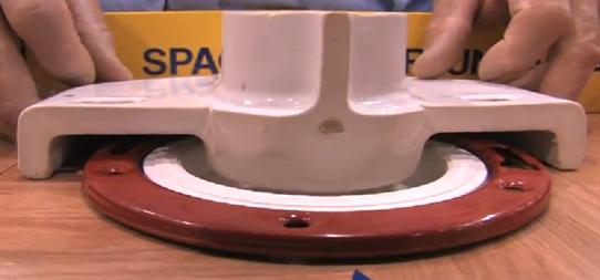

    Hi gnrboyd,
    I am attaching a picture that I got from a video on YouTube. It shows the relative position of a toilet flange with a cutaway of a toilet base. Since you are just replacing your linoleum/vinyl flooring and your flange is resting on top of the finished floor...you're good. I usually use these clear plastic shims to level up the toilet's base...and it has been so long ago that I bought them (in bulk 1000 pcs) I can't even tell you what there manufacturer's name is...However I have seen some at the local plumbing supply houses I go to...
