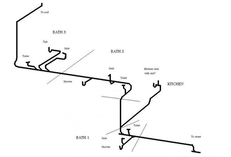

    Here's a quick diagram of the current layout. I apologize for the crudeness of it. Bathroom 3 is the easiest to remedy; I would put the tub and the sink on the same branch, revent the sink, and wet vent the tub via the sink. Bathroom 1 is also relatively easy as I can put a separate vent to atmosphere on that one (it's in a different wing of the house and there's no practical way to tie it to the main vent.) Bathroom 2... is tricky. There's not really ready access to the attic from it from where the sink is located. I have to think on that some.

    Jan 2008
    3,134
    Without knowing what is there to be dealt with, telling you how to run the vents would never work. Every trap needs to be vented, and the trap to vent distances must fall within the maximum allowed for each pipe size.
    Your existing drawing is very nice. If you were to draw in the vents, the pipe sizes, and the distances, then we could tell you whether you are heading in the right direction or not.

    Jan 2008
    3,134
    My first thought is that you must ask yourself "what is the fault, and what is the cause?". Are you planning to cut open all of your walls to install venting because you are bored, or is there something more to it? Depending on the existing pipe sizes and the amount of build up in the pipes, the combined drain and vent system can certainly have issues, which is likely why it is not currently used in the manner which your house is plumbed.
