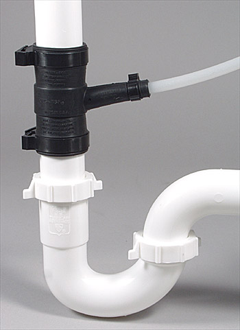

    Posted this in plumbing, but realized it might be more appropriate here:
    Is there any such thing? I am tired of the racket my undersink RO filter makes dribbling the wastewater through a saddle drilled into the top of the garbage disposal lateral pipe. No leaks, but noisy as hell.
    Surely some enterprising young man has addressed this market with a sink tailpiece that quietly trickles the water down the side of the drainpipe into the p-trap through an angled inlet? It needs to mate up to 1/4 polyethylene tubing.
    Or would moving the saddle to the sink downpipe instead of the disposer lateral be enough to quiet it? It is a permeate-pumped 45 gallon per day RO and seems to put out a decent wastewater stream, at least for an RO filter.
    www.airgap.com
    It is 3/8" since that is the correct size for an air-gap faucet. Hope this helps!

    Actually, they say "Inlet port directly accepts 3/8" and 1/2" O.D. poly tubing." And... there's always duct tape. To narrow down their zillion AirGap products, start at http://www.airgap.com/drainFitting.htm.

    Thanks, that looks promising.

    That thought has occurred to me, but I'm sure it will improve on my current maximum-noise drain line connection point. It only became extra annoying after the permeate pump upgrade (which I do like) increased the flow rate.
    Here in California we don't have basements, and I don't have a sump pit. Perhaps I should water some plants with this "waste" water. Oh, but it is salt-softened, so no.

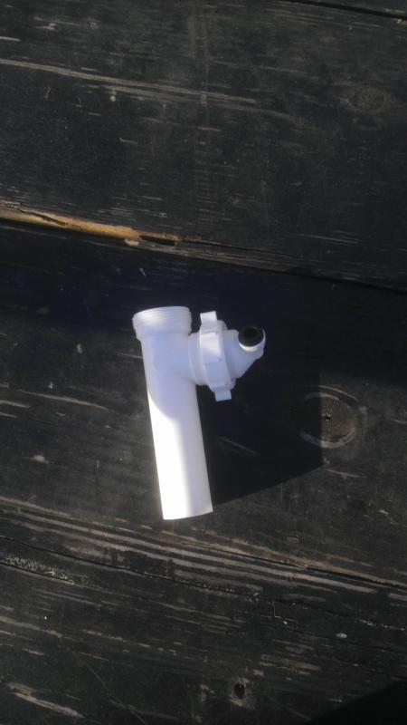

    This is what I use. Work quite well.

    Ja, I could see how that would tend to run the water down the side without splashing.
