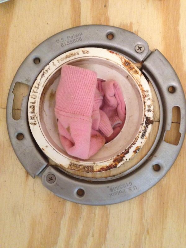

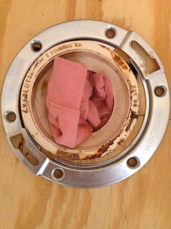

    The flange was rusted on my closet flange so I completely removed it leaving only the PVC pipe. The PVC pipe is a 4" x 3". I read online I could use a moss bay repair flange to fix it. However when I put it around the PVC pipe it is too big. I then tried "the clam" and it is also too big. What am I doing wrong? Any suggestions? Thank you in advance!
    21,390
    The repair ring is designed to notch into the slot of the old flange after carefully splitting the old metal part off...with the old flange gone, you need an entire new flange to be installed. If I'm misunderstanding you, a picture might help us understand what you have now.

    Thanks Jim. My PVC does not seem to have a slot for the flange to fit into. Here are 2 pictures: 1 with the moss bay flange and 1 with the clam.Name:  photo2.jpg

    HOWTODO; great promotional posting, the problem is that he does NOT have a flange anymore. All he has is a "bastard" sized fitting that none of the standard repairs will work with. Part of the problem with using a "RamBit" is that the opening is NOT the proper size for it to slide through, and they work fastest if the pipe is cut off flush with the fitting and not have to "bore" through a length of pipe first. You said the flange fits INTO a 3" elbow which probably means it is a "spigot" flange, and if so, it is the WORST way to attach a flange to the system.
