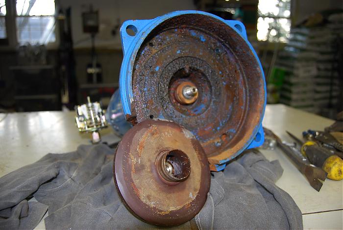

    how do i hold the shaft to remove impeller
    heard that it was on this site but i cannt find it

    The impeller is already off. All that is left is the mechanical seal.

    i need to know to to remove my mine that is just a picture of a pump like mine?
    Moderator valveman's Avatar
    Mar 2006
    Lubbock, Texas
    3,534
    If you can't get a wrench on the shaft between the pump and motor, then you can remove the end of the motor, and there should be some flats on that end of the shaft to get a cresent on.

    Goulds has a service manual on their site. On page 68, it says:
    9. A.O. Smith Motors – Remove motor end
    cover. Insert 7⁄16" open end wrench under
    switch mechanism or behind overload
    protector onto flats on motor shaft.
    While holding the shaft against rotating,
    turn the impeller counterclockwise. The
    impeller should turn completely off the
    shaft in this manner.
