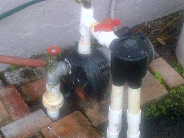

    I have the city water hooked on the inlet end of the pump. in front of the pump threw a water hose valve. In the bottom of the front of the pump there is a plug, I do not see any other plugs anywhere to bleed the system. I never bleed the system, so how am I suppose to bleed the system to get the air out? that is what the pump sounds like it has air in it. I will take a picture of my set up in the morning....thank you

    It sounds like you are keeping the hose hooked to the pump when you start the pump. What you want to do is slowly fill the pump and suction line through the top port on your pump. Allow the air to burp out, refill the pump, burp the air, refill the pump.............When the pump and suction line are both completely full of water, disconnect the garden hose and then turn the pump on. If you don't have a valve on the discharge side of the pump, leave the plug loose so what little remaining air will bleed out.
    Welcome to the world of centrifugal/jet pumps.

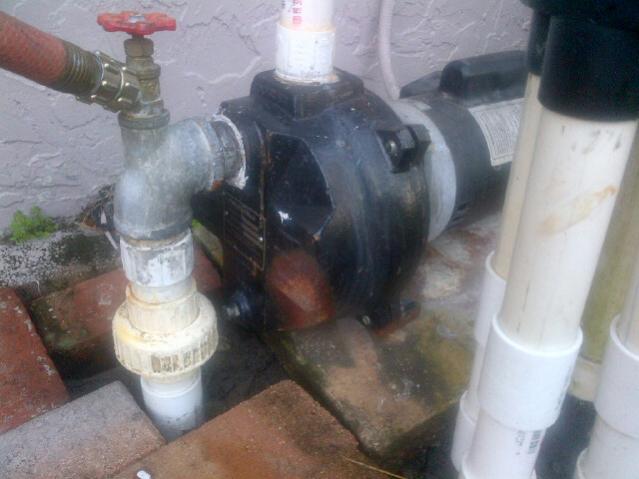

    Here is my well pump, the only bleeder screw I see is that one on the bottom. If that is the bleeder screw, what do I do? remove it completely or loosen it. Again thank you for all the help

    Bleed the air out on the discharge side where the green hose connects.

    Both. Close off the discharge ballvalve. Pressurize the system with city water. Close off the city water. Open the bleed a small amount and turn on the pump. You want it to build pressure but at the same time bleed off the air. If you lose all the pressure, open and close the city water to get the pump wet. Lather, rinse, repeat.
