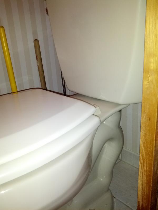

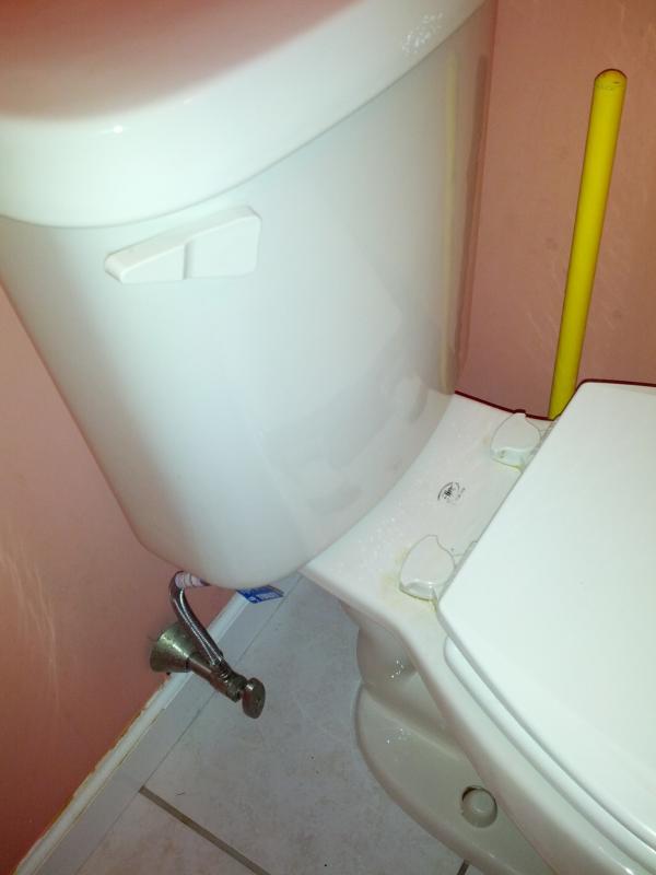

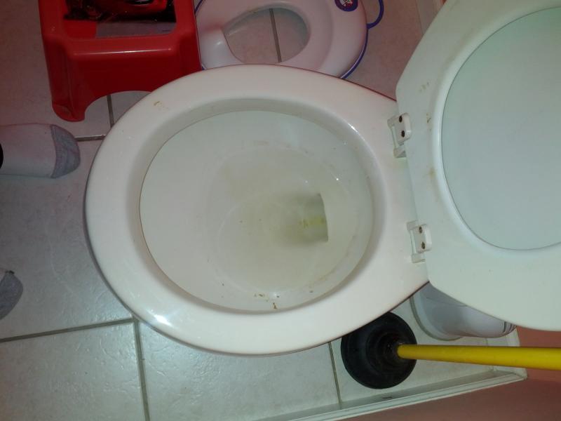

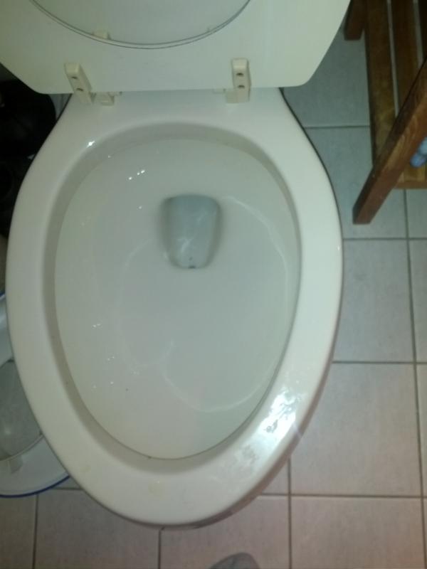

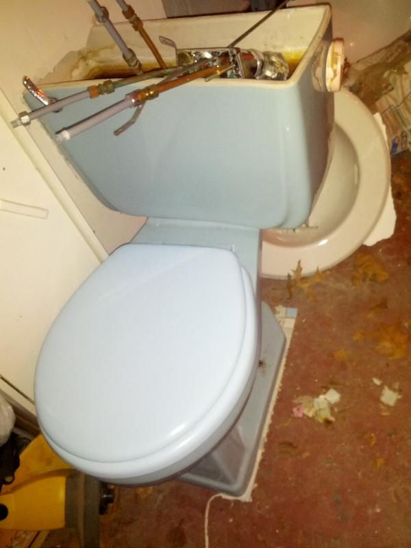

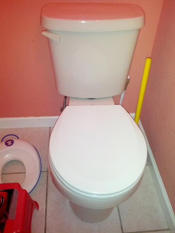

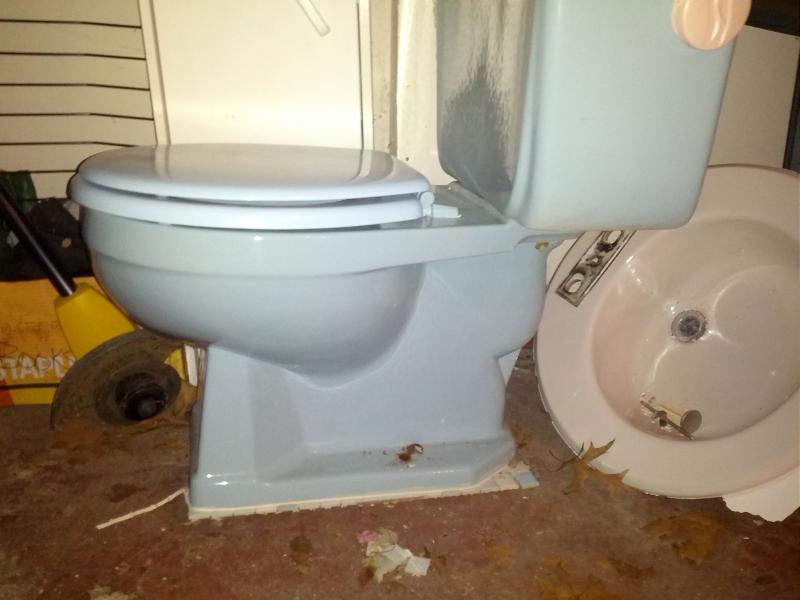

    I have a Kohler, an Eljer, and something blue. The first two pictures are the Kohler, the next two are the blue one, and the last three are the Eljer (the worst of the bunch). I think they're all 1.6 gallon.

    I guess there's a photo limit. Here are the other two pics of the Eljer.

    Thanks for the photos of the toilets! One way to confirm their identity is to look inside the tank and see what numbers are there. On the Kohler, it would be a number that begins with a K, or example.

    OK, the blue one is a Gerber and only says W4. The Eljer says 1410230, and the Kohler says K4620CA. Below the K number, it says 14 97 086. I guess that's easier than posting pictures.

    So we have a Kohler Wellworth circa late 2000s, and an Eljer Cypress. Both of them are 1.6gpf. I'm a little less sure about the Gerber, but I'll look around.
    About the late-2000s version of the Wellworth, Terry said in 2009: "The lower trapway of the Wellworth is known for clogging.
    Elongated bowl, 125 grams
    Regular bowl, 250 grams"
    So the Wellworth of that era wouldn't likely flush as well as the Aquia, all of which have a MAP rating of 500 grams or better (800 on some). Of course, the floor-mount Aquia comes in a number of flavors, one-piece and two-piece, universal-height and not. The Kohler color "biscuit" is equivalent to Toto "Sedona Beige". All three flavors are available in Sedona Beige.

    The Eljer is late 2000s, but the Kohler and the Gerber came with the house, which we bought about 10 years ago.
