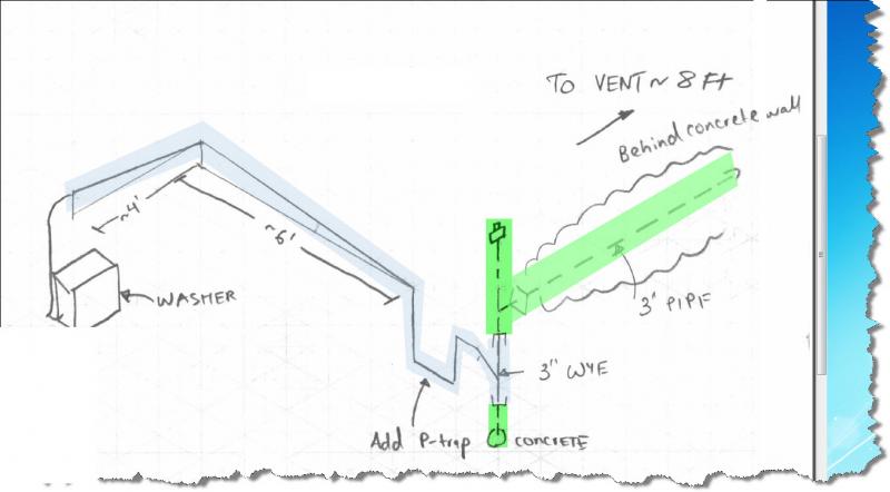

    Just wanted to show more detail of what i plan on doing now:
    Name:  2-5-2013 3-35-01 PM.jpg
    The plan is now:
    1. In the picture above, my existing drain line goes up from the ground and Tees into the concrete wall. I estimate that this drain runs about 8' and is the drain for my bathroom and current washer upstairs. I plan on using this as a wet vent.
    I will put a WYE fitting in between the ground and the existing TEE. Attached to the WYE, i will add a p-trap as you mentioned. I just want clarification, the code states MAX allowable distance between a trap and vent. For a 3" line, i believe that the 8' distance is sufficient in my case correct?
    Is there no code requirement for max length of the horizontal section (from my washer all the way down to the p-trap). Does it matter that the washer is an additiona ~ 6' + 4' = 10' away? Or is it just from the trap to the vent?
    I understand there is a code requirement for max angle change from trap to vent = 135 degrees. In my case, i am only doing a 90 degree turn so that should be ok?
    2. Are there any other issues you see with the sketch i provided? Basically will attach WYE-make a ptrap- and then run horizontal length with atleast 1/4" per 1' slope.
    3. Just wanted to understand the code. What does max allowable fall from a trap to vent mean?
    Thanks

    406.3 Waste connection. The waste from an automatic clothes washer shall discharge through an air break into a standpipe or into a laundry sink. The trap and fixture drain for an automatic clothes washer standpipe shall be a minimum of 2 inches (51 mm) in diameter. The automatic clothes washer fixture drain shall connect to a branch drain or drainage stack a minimum of 3 inches (76 mm) in diameter.
    802.4 Standpipes. Standpipes shall be individually trapped. Standpipes shall extend a minimumof 18 inches (457 mm) and a maximum of 42 inches (1066mm) above the trap weir. Access shall be provided to all standpipes and drains for rodding.
    1002.1 Fixture traps. Each plumbing fixture shall be separately trapped by a water-seal trap. The vertical distance from the fixture outlet to the trap weir shall not exceed 24 inches (610 mm) and the horizontal distance shall not exceed 30 inches (610 mm) measured from the centerline of the fixture outlet to the centerline of the inlet of the trap. The height of a clothes washer standpipe above a trap shall conform to Section 802.4.

    First off, I'm not a plumber and I am also here to ask questions about a project that I am planning. However I have done quite a bit of reading of the Ontario code and I can tell you a few things. There is no way that the trap for the washer will be allowed to be that far from the fixture. The Ontario book states a limit on the length of the 'fixture outlet pipe' (before the trap) of 1.2 metres (about 4 feet). Then, after the trap you need to provide a vent within a certain distance (the vent serves the trap). I know that the numbers for that are different in Ontario from the National Code because my book shows both sets of numbers. After it is vented, then you can run the drain pipe a long distance provided you meet all the rules for running a drain.

    Air has to be able to get from the vent to the trap (going the opposite direction of the water). The max fall is always going to be less than the pipe diameter:
    http://inspectapedia.com/plumbing/Pl...oises_003s.jpg
    The code book will have a table showing the max. distance for each pipe size.

    two note on you plan for venting..
    1 - you can't wet vent your washing machine as it is downstream of the toilet (you mention the pipe is for your washroom)
    2 - your wash machine needs to drain into a standpipe of at least 24" vertical length
    3 - you can only have 1.5m from the standpipe to trap
    4 - connecting the trap to a Y on the vertical pipe would immediately exceed 1 pipe daim fall between trap and drain (it would need to be a T - but you don't have a proper wet vent scenario either way)
