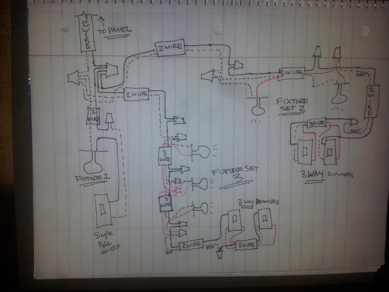

    I am about to start rewiring the lighting in my kitchen. Right now I've got four lights on one circuit controlled by two separate single pole switches (two sets of two lights, each with a separate switch). Currently it's set up with 12/2 wire to the first fixture with the switches at the end of the run. What I'd like to do is add a third set of lights so the setup would be as follows:
    Light Number one: One Fixture, One dimmer switch (easy enough)..
    Light Number two: Two lights and a 3-way dimmer
    Light Number three: Three lights and another 3-way dimmer.
    I'd like to keep the power feed from the panel at the first light and distribute everything from there if possible. Otherwise, I'll have to tear out the whole ceiling. Please see the link below for the diagram. I would really appreciate any suggestions.
    http://share.shutterfly.com/action/w...0CbuXLlq4aNnHQ

    no it will not work and needs a lot of help which i don't have time to do right now
    Jun 2007
    North Carolina
    2,240
    Supply one of the three ways with the power for the circuit and install three conductor (black, white, red) between the two switches and two (black and white) to the light.
    What you have drawn will not work and will only trip the breaker when you flip one of the switches.
    The white conductor when used as a neutral or connect to the neutral is never connected to the switch. It is possible to use the white wire as a colored wired but it must be identified by tape, paint, sharpie or something so it is no longer white.
    23,717
    His drawing is VERY convoluted, but if you enlarge it and trace the wires, it will work. It may NOT be the most "elegant" system, however.

    It took me a while to figure out how to make it large enough to see good but you are correct. My bad

    Thanks for the responses. Any thoughts on how to simplify this? I've thought about running the power to the switch first rather than the fixture but that will involve longer runs and a lot more ceiling demo.
    23,717
    It would "simplify" it immensely if there were some way to run some wires directly rather than using all those wire nuts which will "Fill up" the J-boxes quickly. Your drawing is somewhat vague, but you only want ONE dimmer switch on a circuit. If you use two, assuming they are NOT hi-tech versions operating a central dimming control, they will be cumulative and you will only be able to raise the brightness to the level of the one with the lowest setting.

    Thanks for the info. I've got two sets of these lutron 3 way dimmers. They are a master and slave configuration. I guess I assumed if each set was controlling a separate fixture, they wouldn't interfere with each other even if they were in the same circuit.

    You'd best check the wiring diagrams for your dimmers carefully. Many 3-way dimmers require the presence of a neutral in at least one
    of the switch locations, and your system doesn't seem to provide for that.

    If it is going to be inspected and I hope that it is and you are under the 2011 cycle of the NEC it is required also. This is the reason for post three

    "Being in the same circuit" and "controlling different fixtures" are two different things so we would have to know what you mean by those terms.

    I understand. I'm going to run the power through the power through the switches. I've decided to split this up into two circuits and will follow your advise from post three.

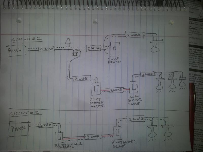

    Right now there are two lights on the same circuit. They are controlled by two separate single pole switches. I want to put them both on three ways and be able to control them independently. It sounds like having more than one 3 way on a circuit is not a good idea so I will wire another circuit and re-route the power through the switches. Right now the lights are at the beginning of the run with the switches at the end. I was hoping to avoid having to rewire.

    Ok... Here's my plan B. I've revised the diagram. I'll have to spend some more time demoing the ceiling but I've got an extra slot I can use, so I'm going to use two circuits. I'll run 2 wire cable to the switches and 3-wire between dimmers. The lights will be at the end of the run. I need to splice the first circuit for the two separate lights. Please have a look. Thanks.Name:  20130203_143458.jpg

    It's fine. Procede as planned.
