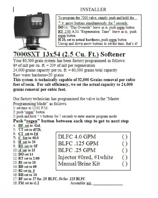

    Now to the softener programming.

    The unit is getting installed tonight and I'm confident that I know everything I need to know with the exception of one thing. If I have a .25 blfc and Ditto's settings sheet has me setting my brine fill for 27 minutes how many gallons of water should I pour into the brine tank when I startup the system?
  10. #40
    Jan 2012
    1,107
    I would put in 5-10 gallons of water, and after you install the system, put the valve into backwash and open the inlet valve very slowly! Just crack the valve and let the air purge out of the system. When you hear only water running to the drain, you can open the water up fully and let the system go through a complete regeneration. I would recommend sanitizing the system, but most people dont do that. A small amount of bleach in the brine tank is all that is needed. a few tablespoons will do.
    After that, you are good to go.

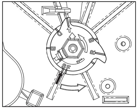

    Well, I got everything up and running but I'm not sure if I have a problem or not so I need some more help. After getting everything put together I kicked off a backwash and after it finished I was getting some hissing coming from where the brine tube attaches to the valve. No leaks but it was making a bubbling and hissing noise and I could see occasional air bubbles making their way down to the brine tank. Not knowing what to do I went in to the house and opened up all faucets tubs and showers to see if there was still any air in the system. Doing this made it better but it still makes a very faint hissing nose and if you stand there long enough you can still see occasional drops of water escaping from the valve. Is this normal? If not, any ideas what I should check out?

    On any new install it is common to get some minor "debris" into the valve assembly. A tiny piece of teflon tape, a few grains of resin, I have even taken apart valves to find packing peanuts inside of them on new installs. Run the system through another regeneration to try to clean out all of the "stuff" from inside the valve. The Fleck valves all use external brine valves that are easily serviced and tested.
    Remove the cover from the valve and confirm it is syncronized correctly. Watch myy video in the link below, it shows how the valve position should be sync'd. Name:  sync.jpg
    If needed, you may need to remove the backing plate, and check the brine valve and the o-ring behind the ceheck valve. This is also shown in the video.
