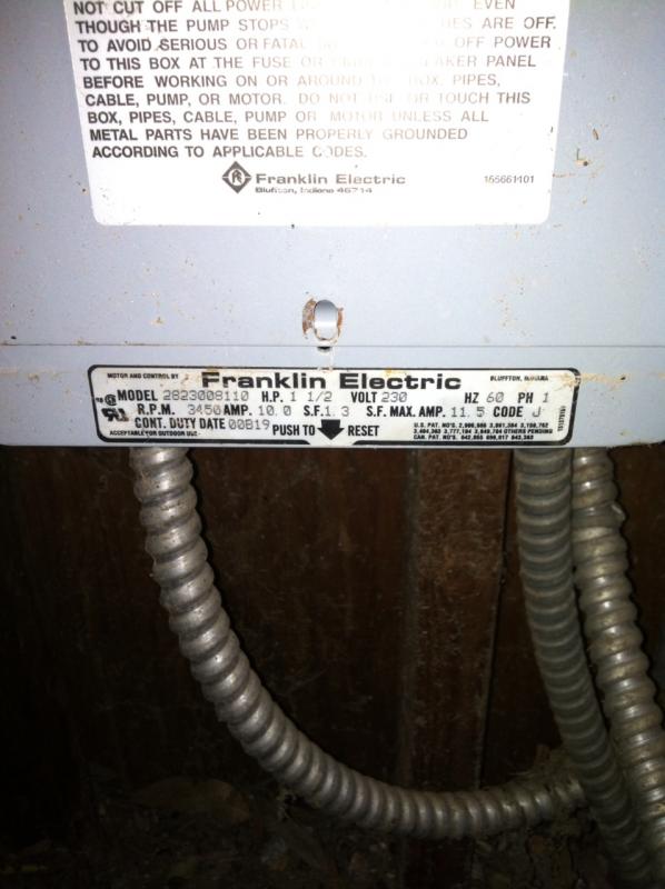

    Default Pump Information
Size:  53.7 KB Here is the tag from the pump. I don't know if this helps.

    Hindsight is 20/20. It has since become obvious from the pic of the Franklin control box that it is not a VFD.
    If/when a pump is short cycling, it spends proportionately more time on the start windings. We know that locked rotor current is much higher than running current.
